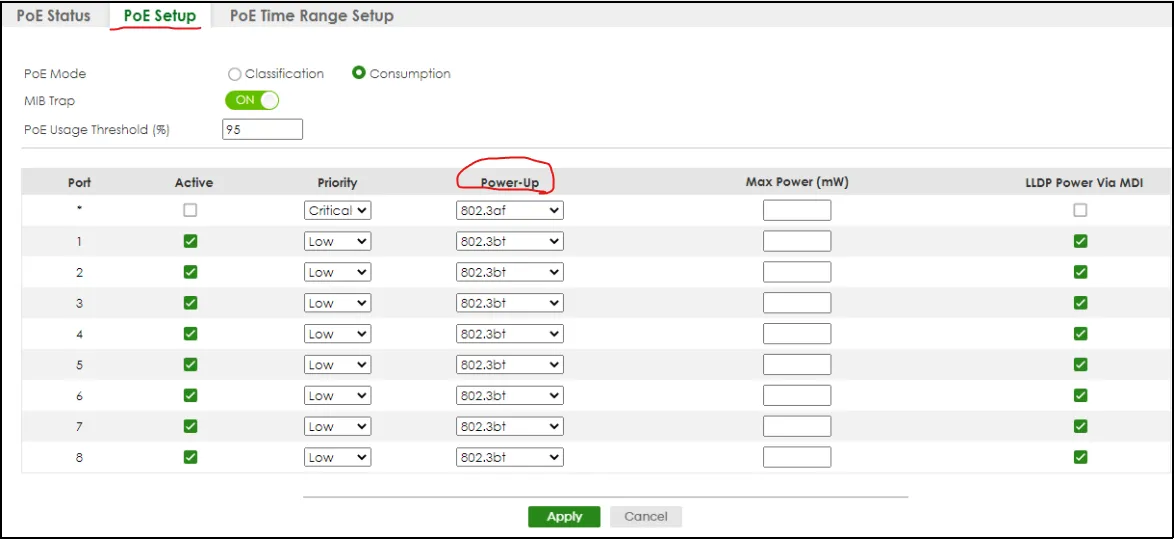

    Additionally, the XMG1915-18EP has a feature called "Force 802.3at", which may help in your scenario.
    You can try navigating to PORT > PoE Setup > PoE Setup, and set the Power-up Mode to Force 802.3at.
    Let us know if changing this setting works for your setup, or if we can assist further.
