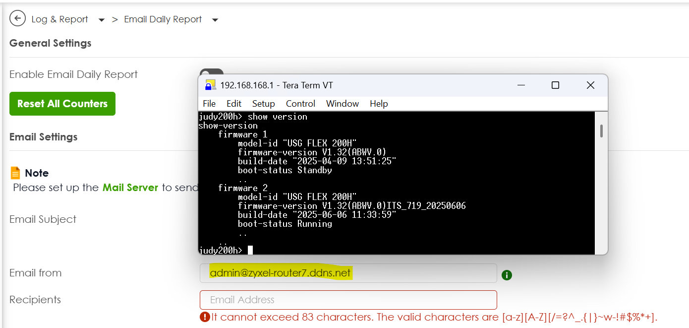

then I tried admin@zyxel-router.ddns.net
and that worked but then could not change it any more went to Notification and changed
Send From to admin@zyxel-router7.ddns.net
and it accepted went back to Email Daily Report and it shows this

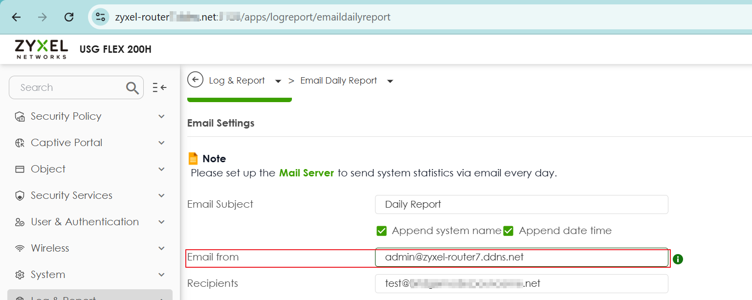

    Hi @PeterUK ,
    We accessed your 200H and confirmed that the FW version is V1.32(ABWV.0)ITS_719_20250606. There is no alert for "Email from" when typing admin@zyxel-router7.ddns.net, as shown in this image.
    Zyxel_Judy
  • PeterUK
    PeterUK Posts: 4,629 image  Guru Member
    hi Judy
    You need to click apply with that Email

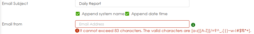

  • PeterUK
    edited July 2025
    Nope problem is back it shows
    put in the Email and apply reload the page shows the same thing
