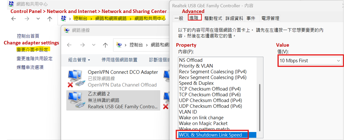

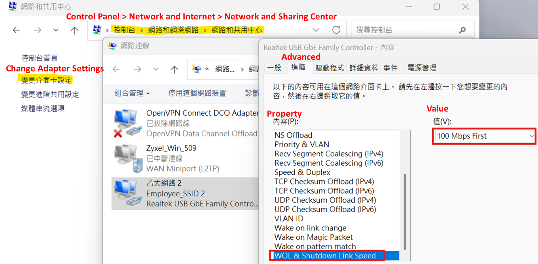

    Hi @LPSt,
    Issues with Wake on LAN can sometimes be related to compatibility or interaction between the switch port and the client's network interface card (NIC). Generally, the link would speed down to 10 M/F after the PC enters sleep mode.
    If the NIC supports WoL, try adjusting the following settings on the client device:
    1. Open the Control Panel.
    2. Go to Network and Internet > Network and Sharing Center.
    3. On the left side of the window, click on Change adapter settings.
    4. Right-click on the network adapter you want to configure (e.g., Ethernet or Wi-Fi) and select Properties.
    5. In the new window, click the Configure button.
    6. Click the Advanced tab to see the list of properties.
    7. Select the WOL & Shutdown Link Speed option.
    8. From the "Value" dropdown, select the ‘100 Mbps First’ or ‘Not Speed Down’ option. image.png
    Also, please ensure:
    • The ‘Wake on Magic Packet’ property is set to enabled.
    • The client's network adapter driver uses the latest version.

    Hi @LPSt,

    Hi @elbrus77,
    Welcome to Zyxel Community!
    The XMG1915-10E switch is a multi-gigabit device whose ports only support 100 Mbps, 1 Gbps, and 2.5 Gbps speeds. Therefore, it does not support 10 Mbps. In addition, when your NAS is in sleep mode and tries to connect at 10 Mbps, it won't establish a proper link.
    As mentioned in the previous reply, you should configure the WOL speed on your NAS to use either "100 Mbps First" or "Not Speed Down" to match the switch’s supported speeds.
    Zyxel Tina
