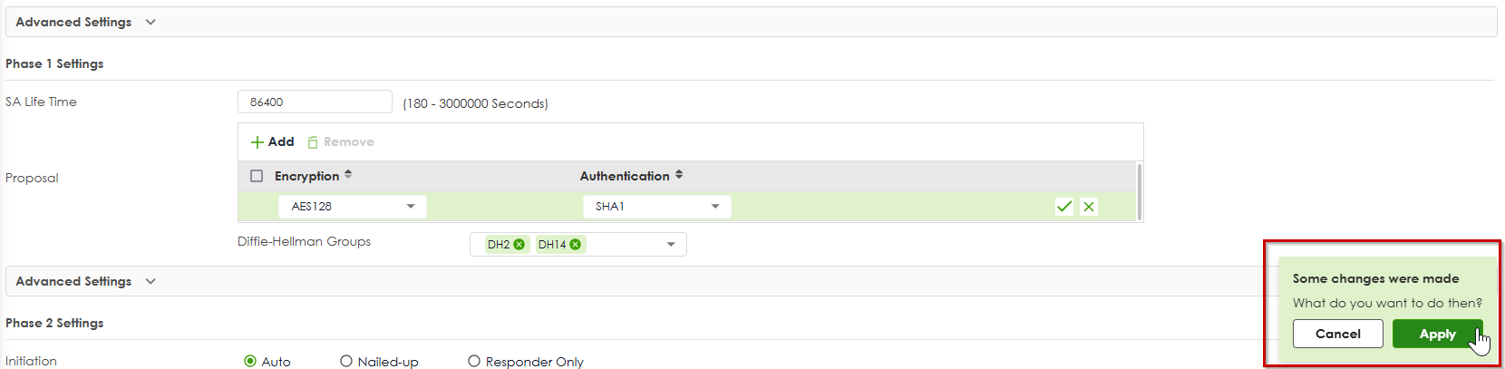

Hello everyone,
when you go here to create a VPN on prem:
You cannot edit Authentication SHA1 to SHA256 :
and save it because it reverts back to SHA1.
Same thing with Proposal:
You have to add a new line with SHA256 and delete the old one with SHA1, like this:

  • PeterUK
    PeterUK image  Guru Member
    edited June 2025
    When you change the Authentication SHA1 to SHA256 you must click the tick button (on the right) then click apply
  • Zyxel_Ivan
    Zyxel_Ivan image  Zyxel Employee
    Zyxel Certified Network Engineer Level 2 - WLAN Zyxel Certified Network Engineer Level 2 - Nebula Zyxel Certified Network Engineer Level 2 - Switch Zyxel Certified Network Engineer Level 2 - Security
    Hello @GiuseppeR,
    Based on your description, I guess after you chose SHA256, you didn't click the tick on the right-hand side and click Apply in the lower right corner?
    If so, I suggest you click the green tick on the right-hand side before clicking Apply.
    Please share feedback from you.
    Thanks.
    Ivan

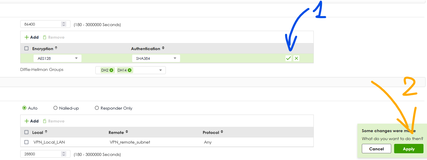

  • GiuseppeR
    GiuseppeR image  Guru Member
    Hello @Zyxel_Ivan
    you are right.
    My scenario was like this:
    But I thought that the 1 "blu arrow" was not needed when clicking 2 "orange arrow".
    I did not considered it, seeing the Green button with "Apply".
