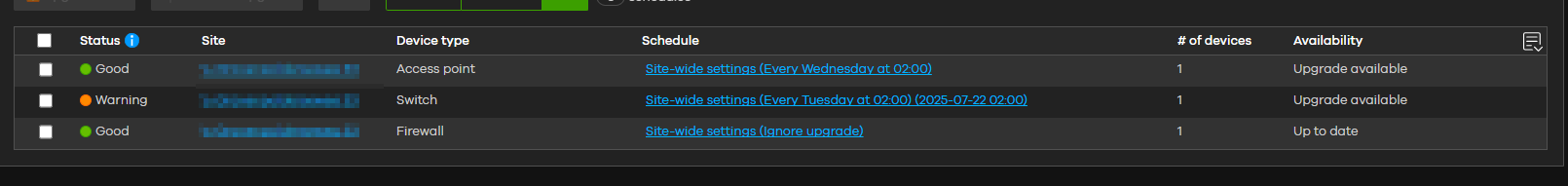

    or maybe use row names like in the nebula table:
    status, and availability
