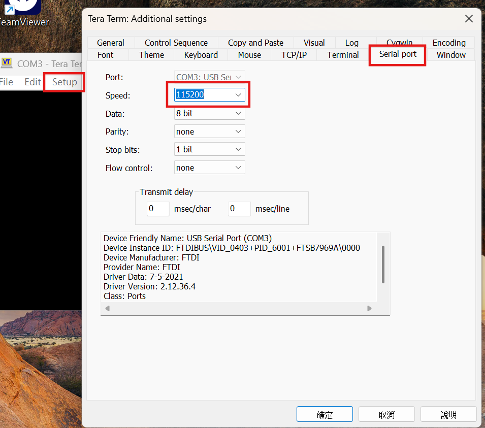

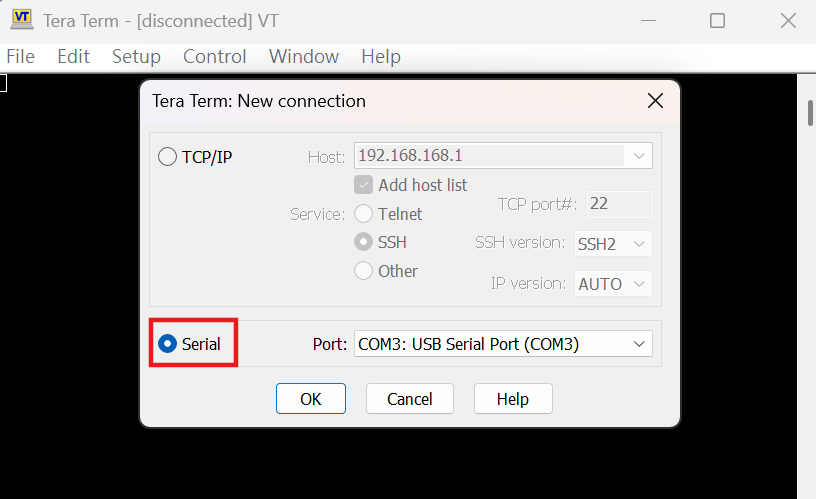

    1. Connect your PC to the device's console port using a serial cable (e.g., via USB-to-serial adapter).
    2. Use a terminal emulator like TeraTerm to open the console.

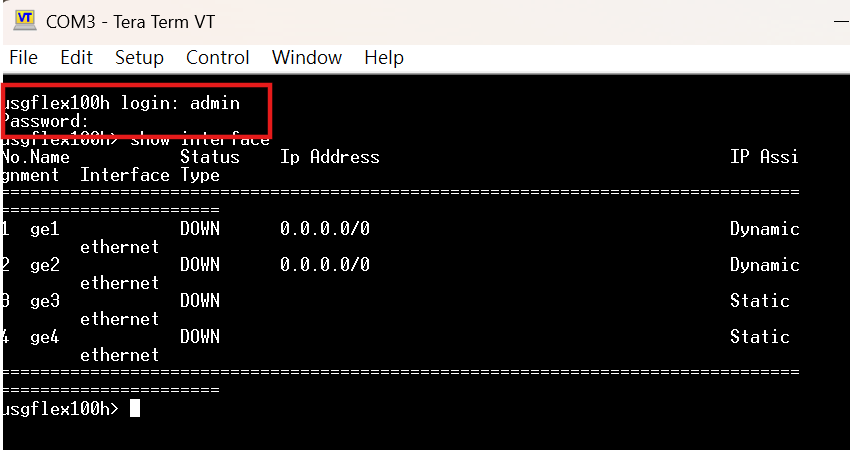

    3. First, establish a proper connection and confirm the console is working correctly — you should see a login prompt or system messages upon connection. image.png image.png image.png

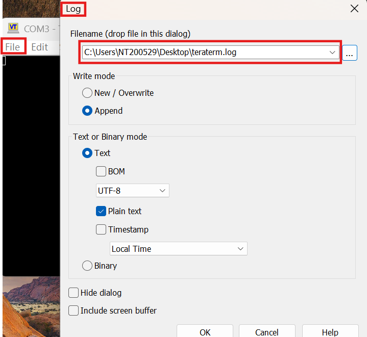

    4. Once the console is confirmed to be functional:
      1. Go to File > Log... and enable auto-saving of the console output to a text file in your desired storage path on the PC.
      2. Please make sure to keep the console session running and avoid pausing or closing the window, so the PC can continuously capture the log during the entire process. image.png
