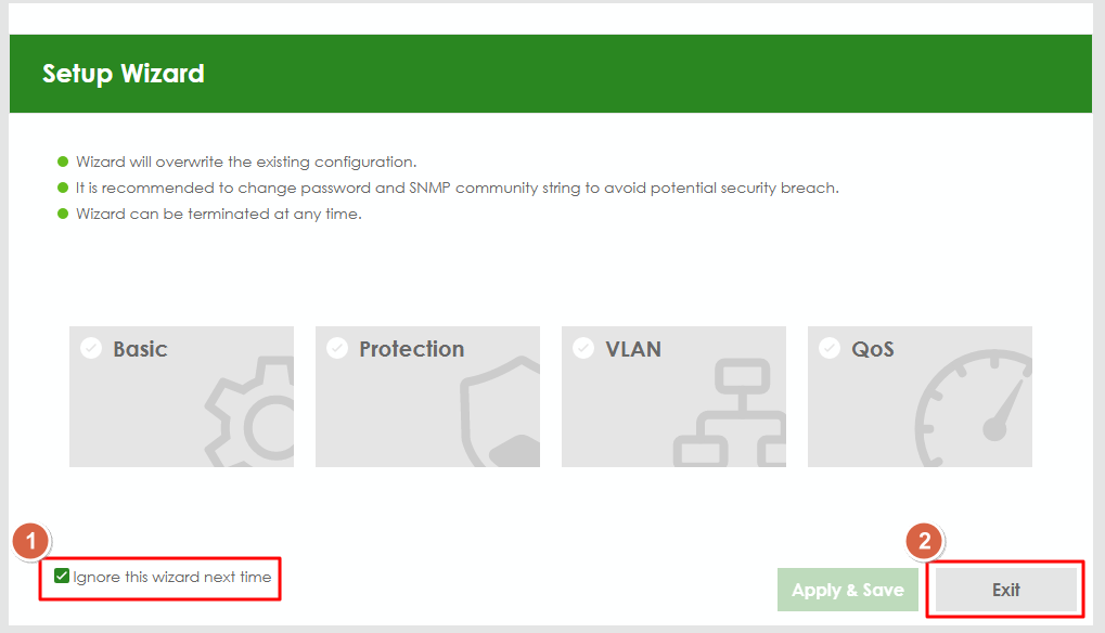

    Hi @Montland
    Not sure if you still keep in the Wizard page, if so, please leave the Wizard setup, and you will find other settings.
    Additionally, the Wizard setup is used for initial setup. It is not recommended to set up with wizard again since it will overwrite the existing configuration.

    Hi @Montland
    Wizard only provides those four options, however, that is not the whole features that XMG1915 supports. Please reference this video for the features XMG1915-10EP supports:
    https://jam.dev/c/c853342d-ba14-4c7c-a5e9-3393f65635f8
    Also, you don't need to change to Nebula since the reason you mentioned.

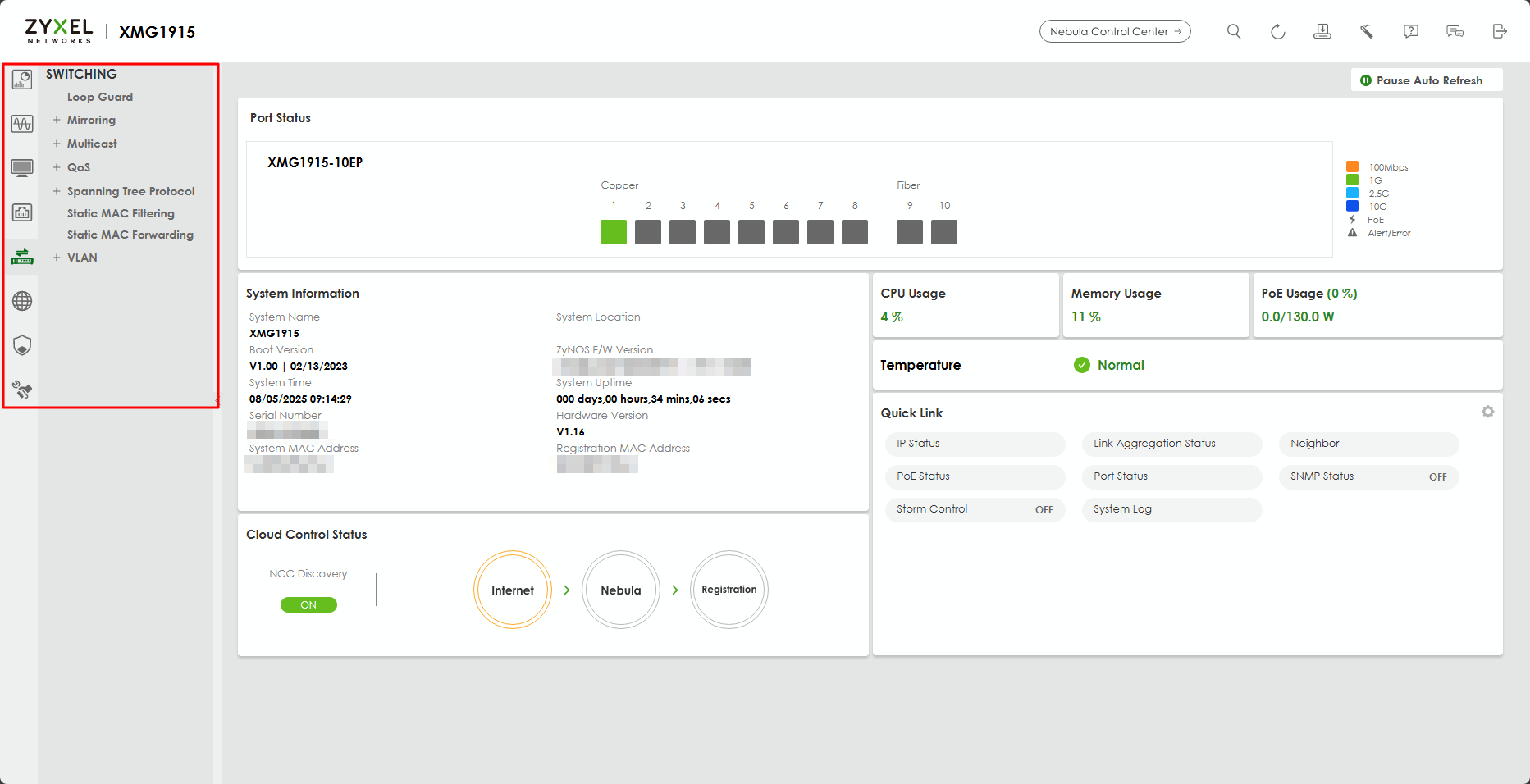

  • brucebarelly
    brucebarelly Posts: 5
    image  Freshman Member
    Hi all, I'm in the EXACT same situation.
    Here are my switching options which are limited according to some previous posts. Please advise. Thanks
  • Zyxel_Melen
    Zyxel_Melen Posts: 5,283
    image  Zyxel Employee
    Hi @brucebarelly
    Your XMG1915 is still in cloud mode. Seems like you want to run standalone mode, but didn't remove it from your org.
    Zyxel Melen

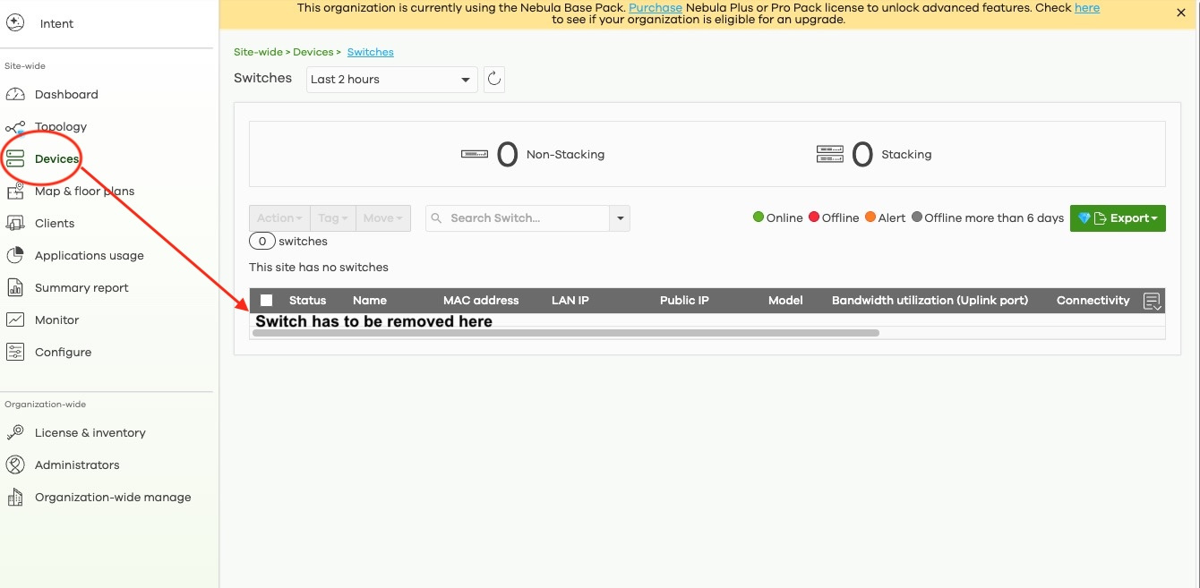

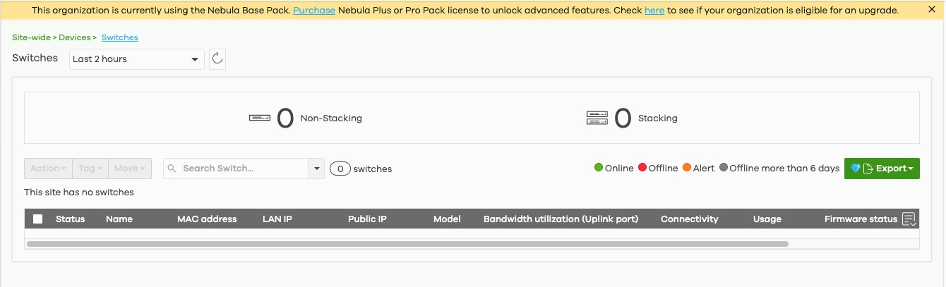

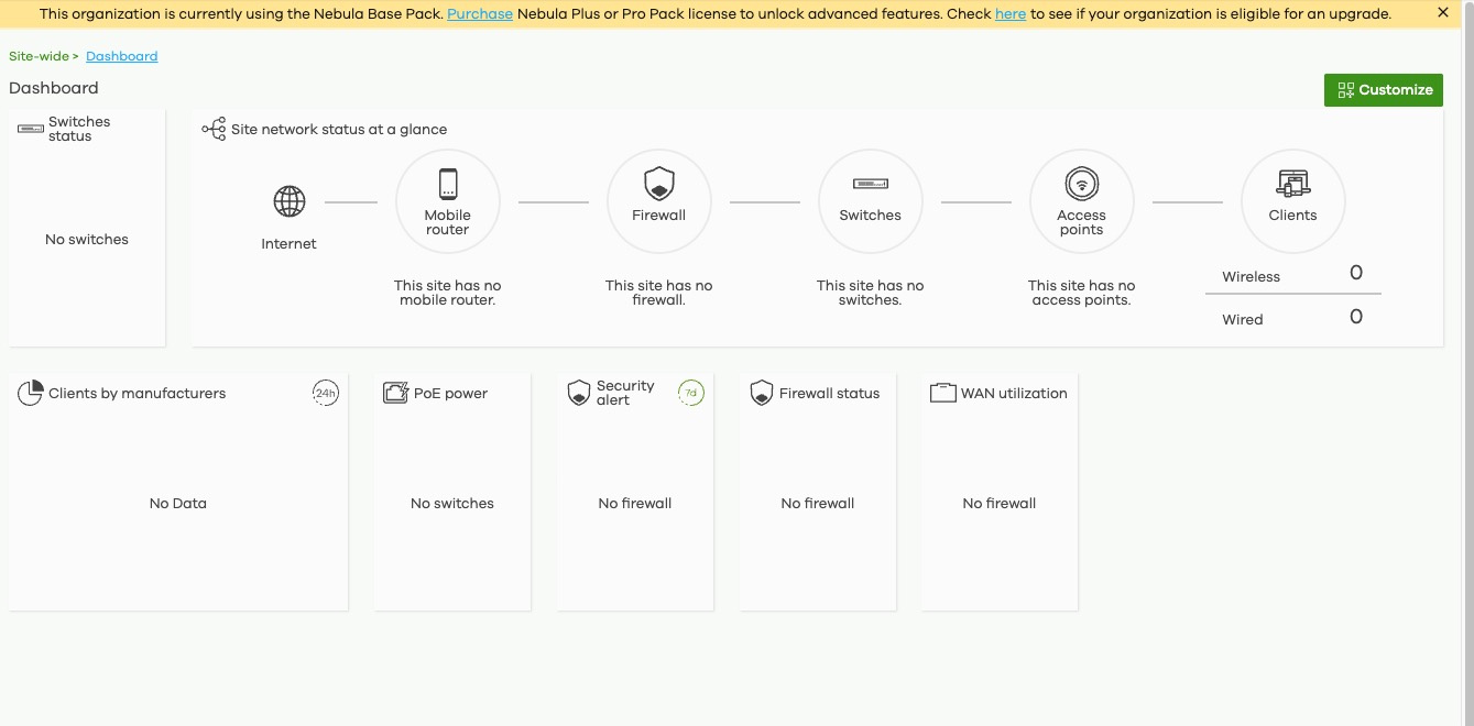

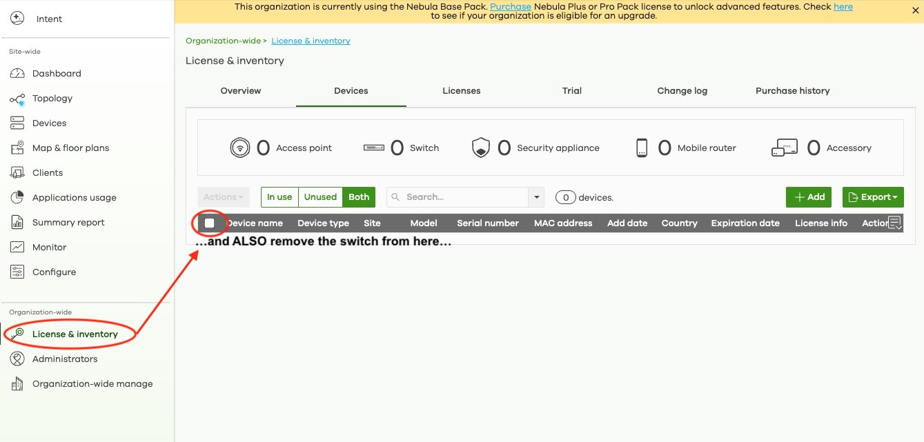

  • brucebarelly
    Helo Melen,
    Thanks for your response.
    I've removed the switch from my organisation before returning to standalone mode. (see images below).
    I've rebooted several times, numerous hard rests, nothing works. Sigh…
    Capture d’écran 2025-11-05 à 10.18.59.jpg Capture d’écran 2025-11-05 à 10.19.09.jpg
