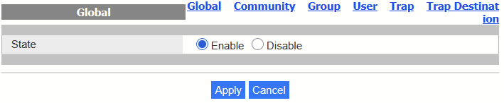

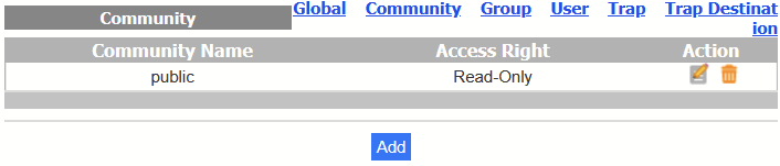

On my switch snmp is activated with the default community :

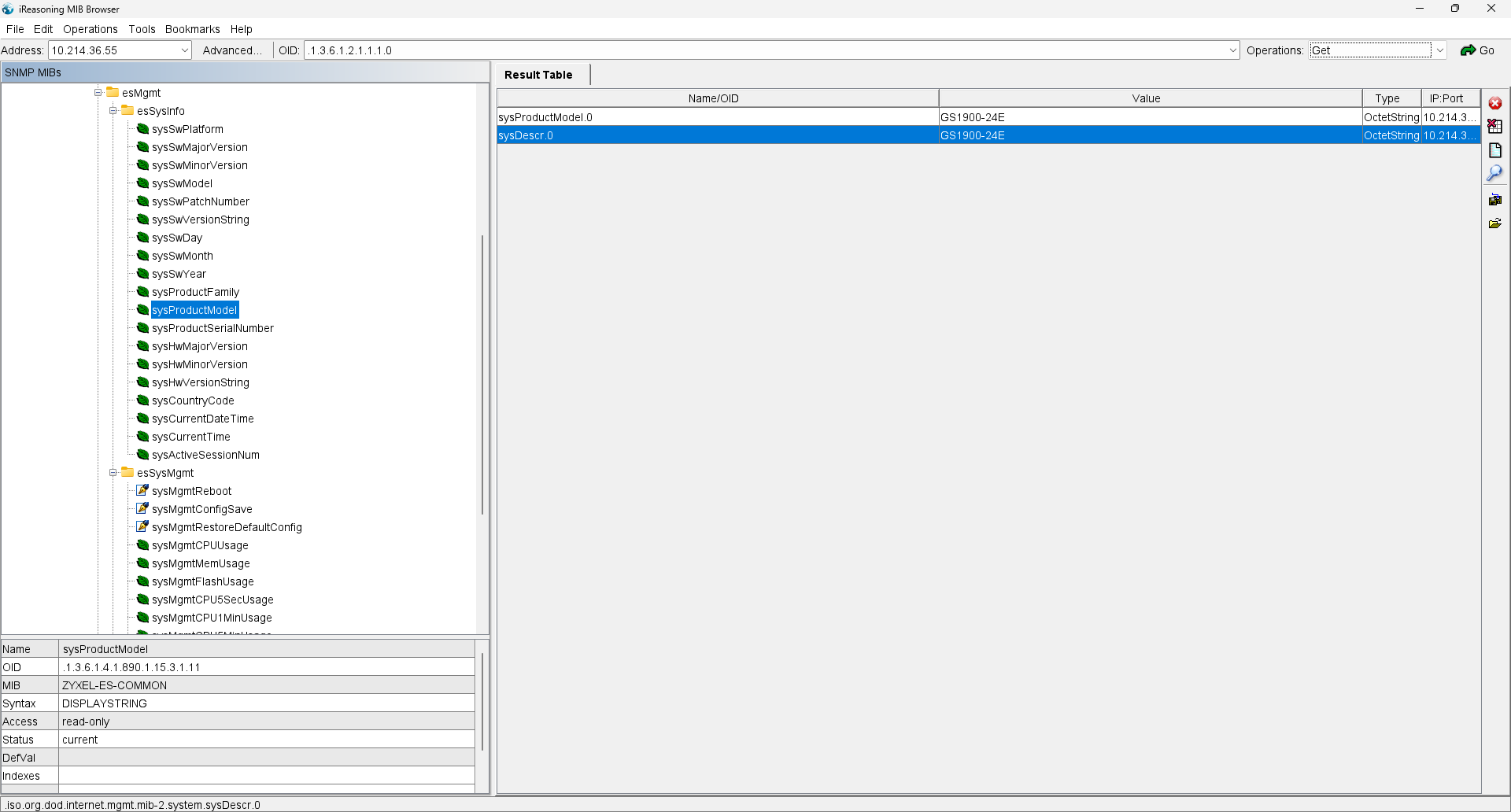

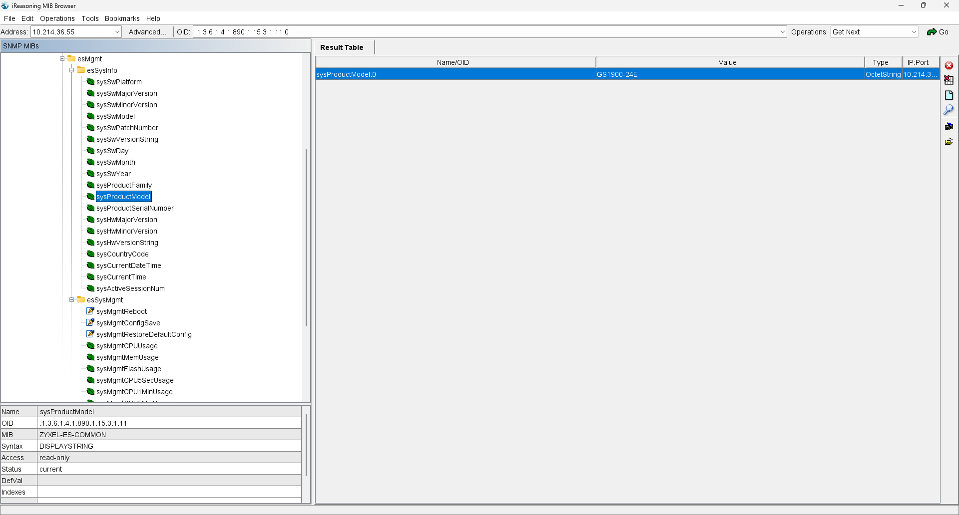

I used iReasoning MIB Browser to get .1.3.6.1.4.1.890.1.15.3.1.11, and I can get the correct information.
Accorrding to your snmpwalk result, it shows that it used the public MIB/O.I.D. to get the information. GS1900 supports Zyxel private MIBs and public MIBs, so you can use the .1.3.6.1.4.1.890.1.15.3.1.11 or .1.3.6.1.2.1.1.1.0 to get the product model information.
