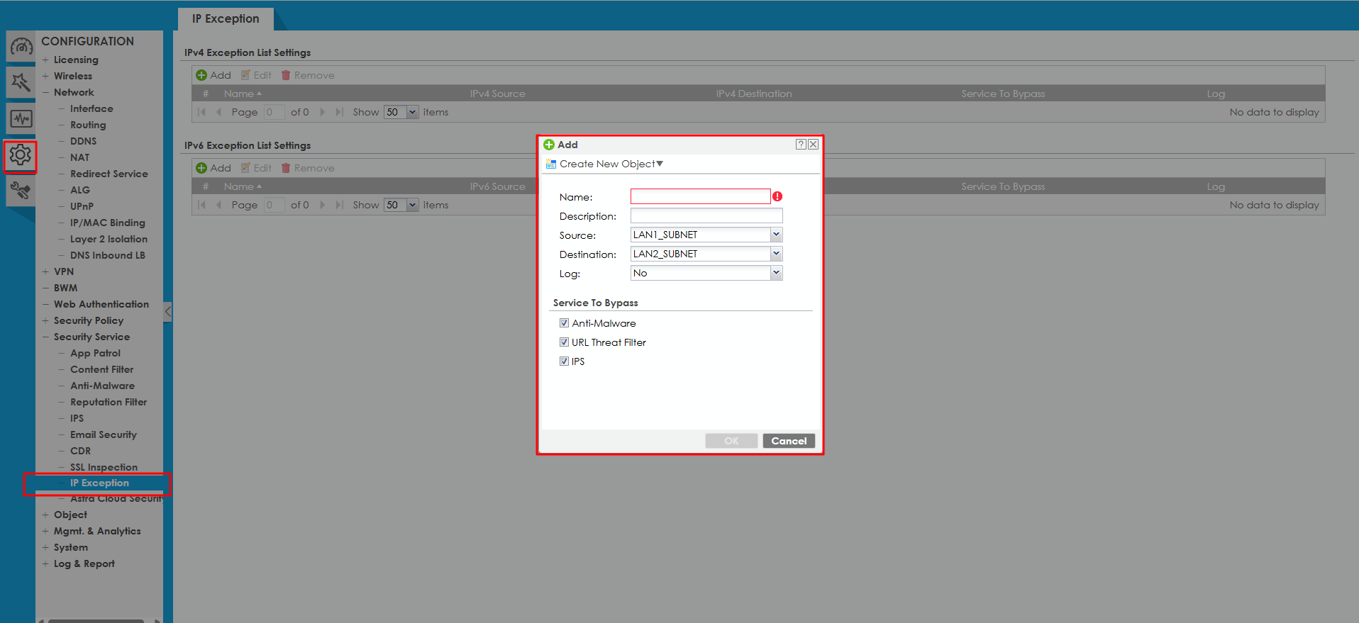

    Thanks for your update. For the main issue, we are still clarifying it. However, I want to let you know that the security services that affect the transmit speed are Anti-Malware and IPS in a cross-subnet scenario. According to your comment, it appears that you are only bypassing the content filter and application patrol. Could you create an IP exception policy for Anti-Malware and IPS for internal LAN subnets?
    Additionally, the IP exception policy is not bidirectional. It only applies to the direction you set.

    @Zyxel_Melen Thanks. Based on your response, we've made the following changes.
    1. Ran iPerf test from my PC to the server and got 36.8 MB/s
    2. Added an IP Exception (all services) for my PC to the server IP range
    3. Ran iPerf test and got 38.6 MB/s
    4. Added an exception for the server IP range to my PC
    5. Ran test and got 37.3 MB/s
    Unless I misunderstood what you asked, it does not seem to have made any difference.

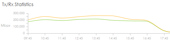

    Is there any way to get better metrics on what system usage is like? The dashboard view doesn't show a whole lot. Kind of have to guess what is going on. Anyway, according to the graph, the highest TX (yellow) is 265 Mbps and the highest RX (green) is 215 Mbps. Since those happen at the same time I expect those need added together for a total of 480 Mbps. If UTM throughput for the ATP is 1900 Mbps (UDP), but we lower that to 1400 Mbps (TCP) just because, the attained speed is 1/3 of the total available throughput. That said, naturally this would be limited by the ATP only having 1Gb Ethernet uplink, but that would still be almost double. Double the performance would be great. Can the uplink limitation be improved by creating a LAG for it? I understand we won't exactly get faster speeds, but I would expect the ATP to receive more data and since there is room for processing be able to process it. Maybe that isn't correct. I understand enough about networking to be dangerous :-)
