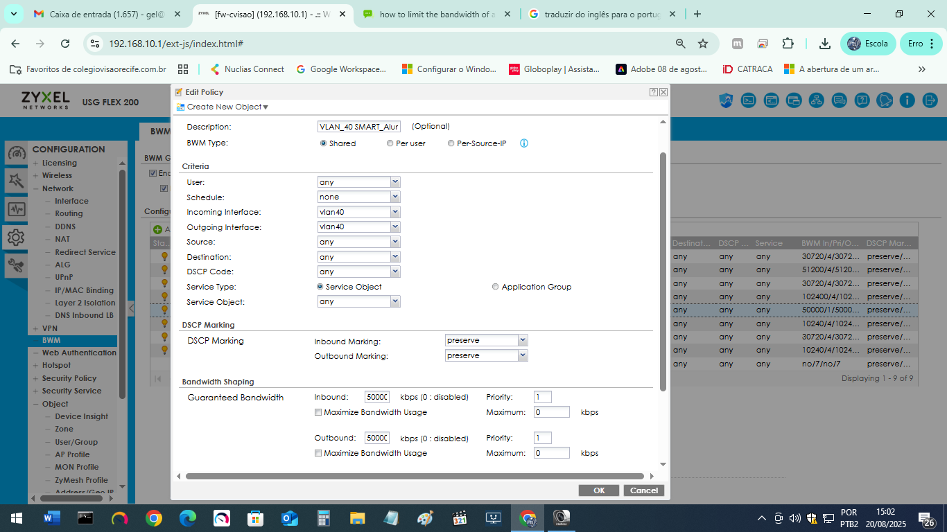

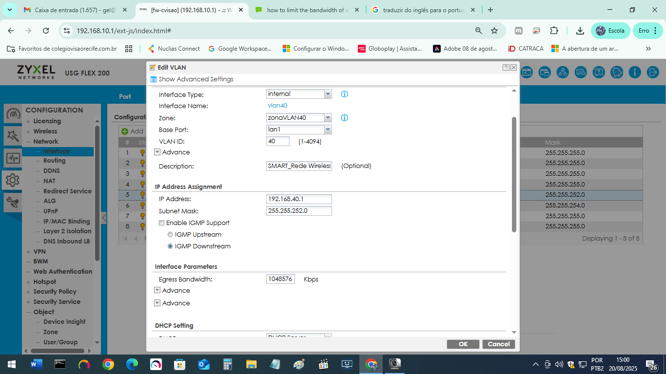

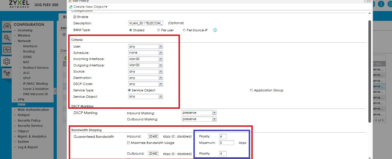

    1- I have this VLAN40 for example. Would the configuration be the same in this part?
    2 - in BWM, editing vlan40, what do I need to change in these options so that its bandwidth is 50Mb?

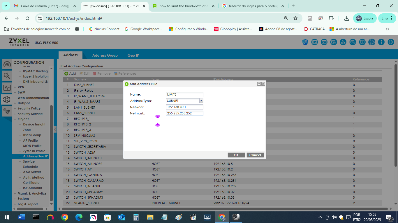

    3- In address/Geo ip, do I need to create this rule?
    I've tried everything and I can't limit the download and upload bandwidth of the VLANs. If anyone can help me, I'd be very grateful.

    Hi @Gel,
    From the second screenshot you shared, if your goal is to allow the traffic between VLAN40 and the WAN and limit the speed to 100 Mbps, you will need to adjust the BWM (Bandwidth Management) settings.
    Specifically, the Outgoing Interface should be set to the desired WAN, and the Guaranteed Bandwidth should be configured as 100,000 kbps.

    So back to you have 500Mb download limit and you have two subnet LAN and VLAN on VLAN40 interface where its got Egress bandwidth you limit at 100Mb along with your BWM rule to Guaranteed speed then on the other LAN subnet for interface Egress bandwidth you limit at say 380Mb~

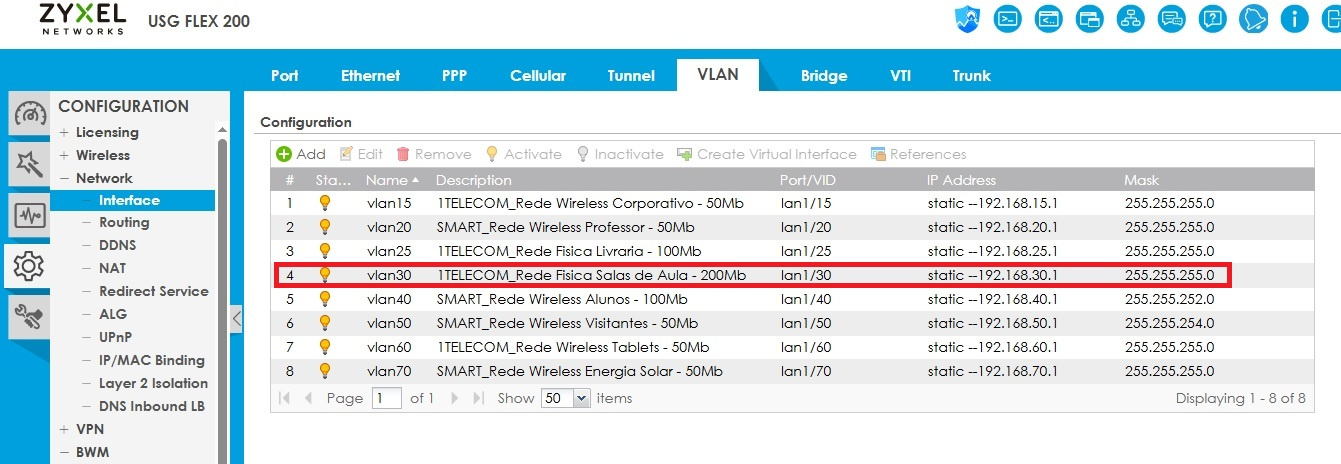

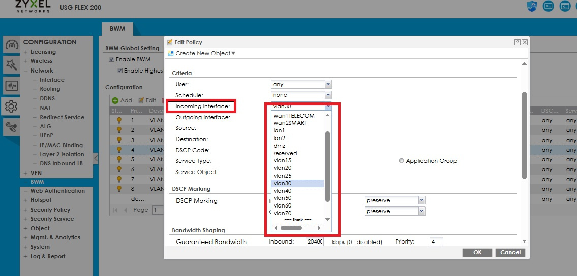

    Hi guys, I haven't been able to get it to work yet and I don't understand it. Let me give you more details.

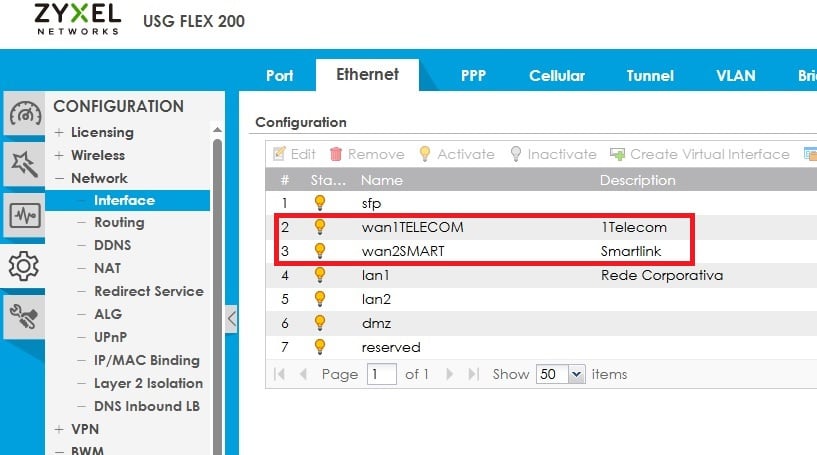

    1- I have two WANs coming into the Flex 200 firewall, UMTELCOM and SMARTLINK. Each of them provides 500Mb Full Duplex speeds.
    2- I created several VLANs, and let's take VLAN30 as an example. I need to limit the speed of anyone using VLAN30 to 200Mb.
    3- I created a shared BWM rule. The problem is that it's not working. Regarding the priority, it is already marked as 4 in the firewall, should I change it?

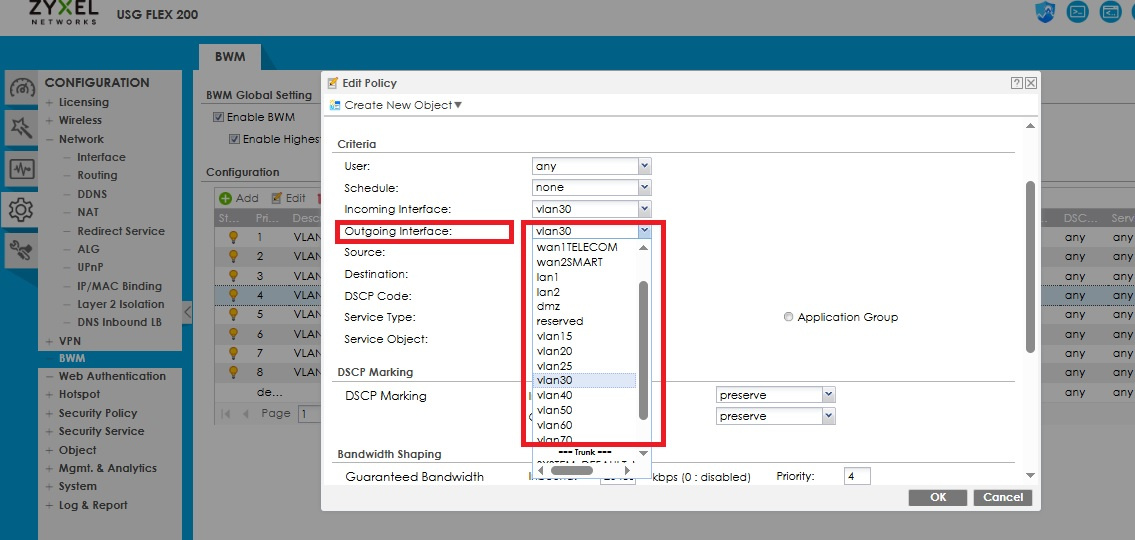

    4 - In the incoming interface option, what should I select? Should I select WAN1TELECOM, which is where this VLAN30 will receive internet?
    5- What should I select for the outgoing interface? What is the correct configuration for these options?
    In my configuration I set VLAN30 for outgoing interface and VLAN30 for incoming interface, but this does not limit the speed.
    I would like to understand the issue of input interface and output interface.
    I really appreciate everyone's patience.
  • PeterUK
    PeterUK Posts: 4,609 image  Guru Member
    So your trying to limit the same subnet like PC1 192.168.30.2 and PC2 192.168.30.3 to 200Mb each other? in which cause this will not work their are ways to make it work however.
    Unless your trying to limit from LAN to WAN in which case you don't set outgoing a LAN but WAN
  • Gel
    Gel Posts: 36 image  Freshman Member
    First Comment Friend Collector Fourth Anniversary
    I want to limit the internet coming in from the WAN on the firewall so that everyone connected to the switch via VLAN 30 gets 200 MB. This 200 MB isn't for each person, but for everyone, combined.
  • PeterUK
    edited September 2025
    So how it the connection being made? In most cases the client will be making the connection outbound so you need the BWM incoming VLAN and outgoing WAN you then set a limit inbound and outbound Guaranteed of as low as 64 Kbps then set the maximum box with inbound as 204800kbps and outbound the same if needed.
    You can also limit the interface on Egress to 204800kbps which is a better option more advanced (but I have not tested but should work) is the use of Per-Source-IP of the VLAN subnet such that if you do interface on Egress to 204800kbps you can make a BWM rule with like incoming VLAN outgoing WAN limit inbound and outbound Guaranteed bandwidth as per source IP and set Maximize Bandwidth Usage as you have limited max inbound by interface on Egress.
