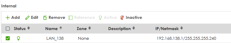

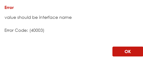

Unable to delete interface
PeterUK
PeterUK Posts: 4,608 image  Guru Member
edited August 2025 in USG FLEX H Series
FLEX H V1.35
seems like if name has "_" in it

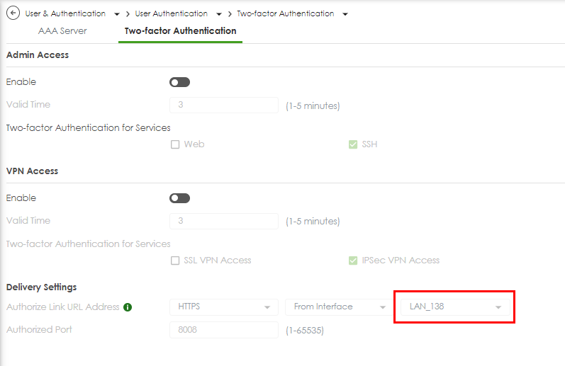

    Hi @PeterUK
    This issue is because this interface is still selected in two-factor authentication.
    Please change this interface and you will be able to delete this interface.

  • Zyxel_Melen
    Zyxel_Melen Posts: 4,992 image  Zyxel Employee
    Answer ✓
    Hi @PeterUK
    Zyxel Melen
  • PeterUK
    Thanks Melen
    That did it
