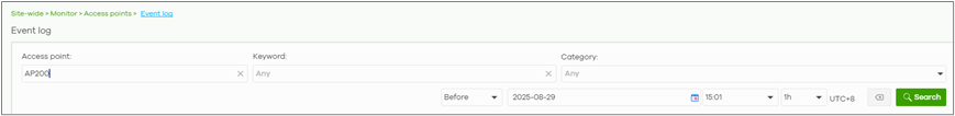

    3. Review the AP's Event Log
    Navigate to Site-Wide > Monitor > Access Points > Event Log to examine related events. Enter the name of your NWA50AX as a filter to display events specific to this access point. Please provide us with a screenshot of the event log for further analysis.
