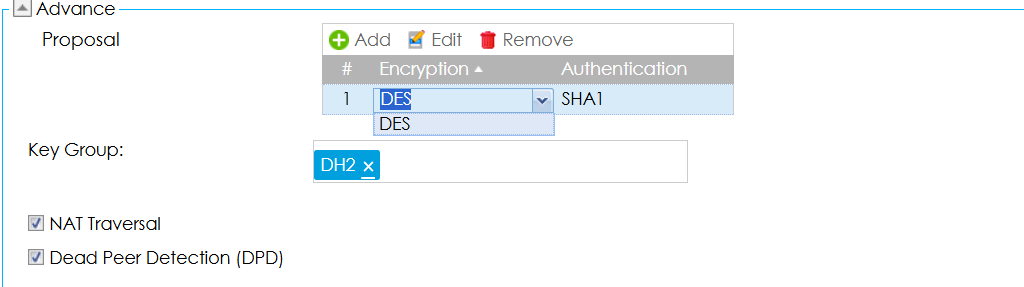

The strange part:
In Configuration > VPN > IPSec VPN > VPN Gateway, under Encryption, the only available option is DES.
AES128/256 and 3DES are completely missing.
The issue is that:
- Windows client by default uses DES/SHA1/DH2, so DES should match, but the tunnel never comes up.
- On older firmware versions (based on community feedback) AES/3DES could be selected.
- On my firmware (V5.40(ABUH.0), 2025-05-07) only DES is available.

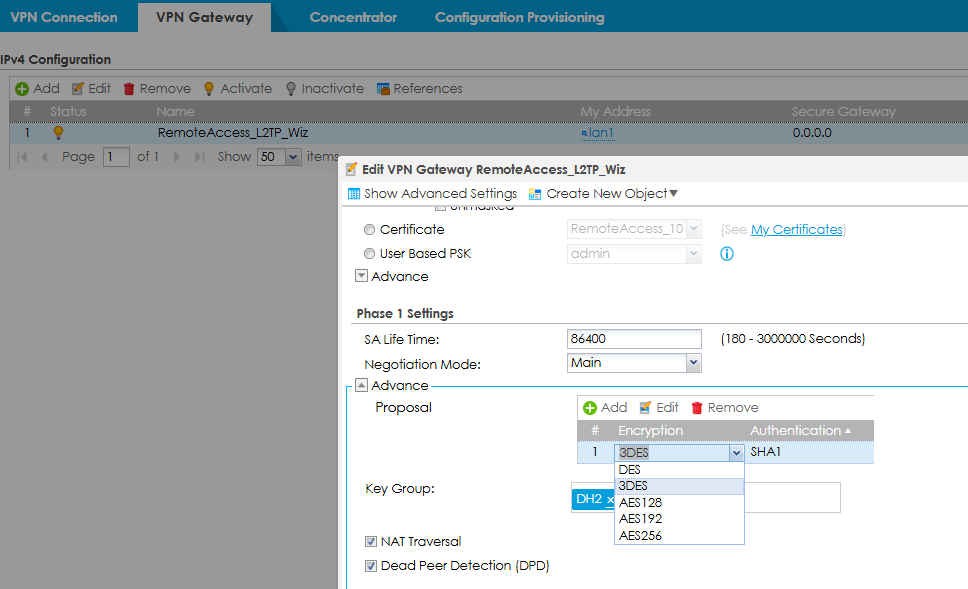

We’ve tested the same model (USG FLEX 100) with the same firmware version V5.40(ABUH.0), and after configuring the VPN via the Wizard, going to Configuration > VPN > IPSec VPN > VPN Gateway, we can see the Phase 1 proposal is 3DES/SH1 and the full set of encryption options (DES/3DES/AES128/AES192/AES256).
To move forward, we recommend:
- Backup your configuration first.
- Double-check whether your current VPN settings fully match the wizard-created config.
- If possible, try deleting the existing VPN configuration and recreating it from scratch using the Wizard.

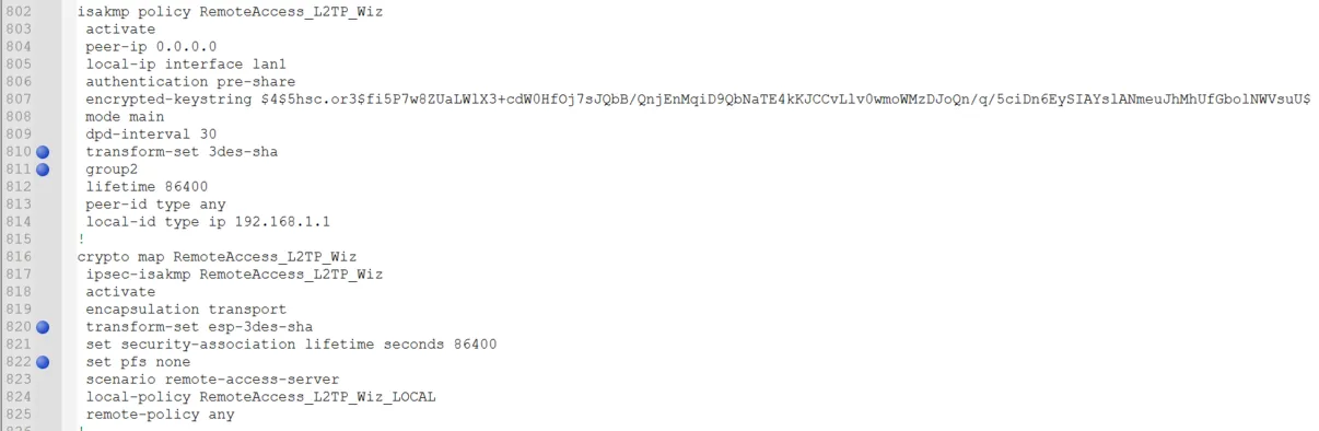

- If the issue still persists, please refer to the commands shown in the configuration image above and set them up via CLI.
