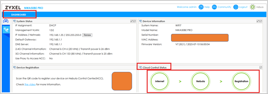

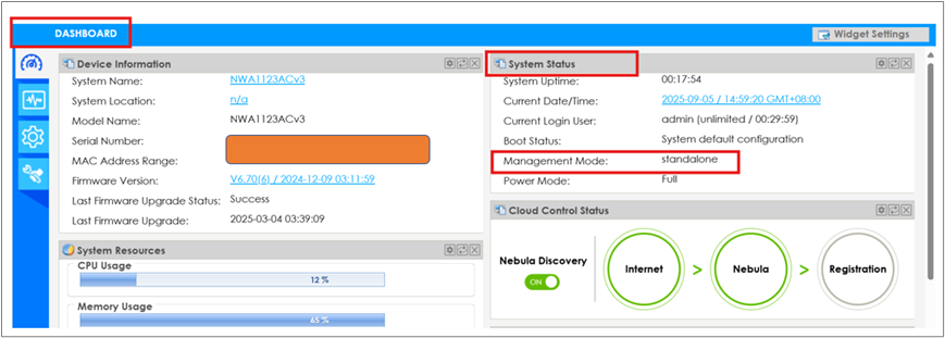

To address the issue, please verify the Management Mode of your NWA1123-AC2 first. Navigate to Dashboard of the Web GUI to check the AP’s management mode.
The AP in Standalone mode
If the AP is in standalone mode, the management mode status would display as ‘Standalone’.
The AP in Cloud mode
If the AP is in Cloud mode, the Cloud Control Status would appear in the dashboard and the three Circles (Internet, Nebula, Registration) would display in green

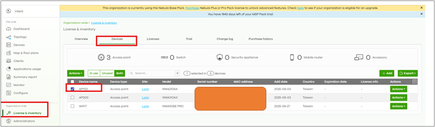

Please log into NCC using your account. Navigate to Organization-wide > License & Inventory > Devices. Locate your AP in the device list and select the AP you want to remove from cloud management.

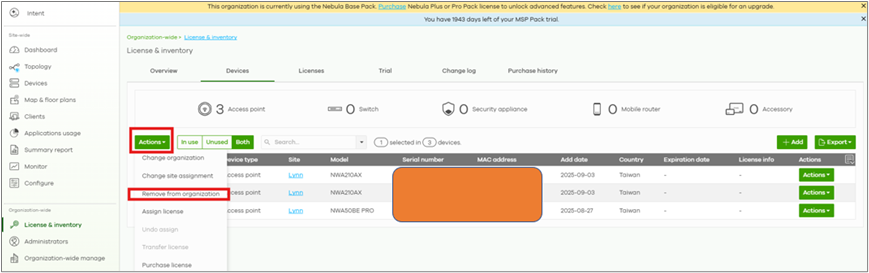

Click the Action button and select "Remove from organization".
After successfully removing the AP from the NCC organization, wait 2-3 minutes for the change to take effect. Then, log back into the AP's web GUI using its local IP address. You should now have full access to all configuration options since the AP will operate in standalone mode with complete local management capabilities.
