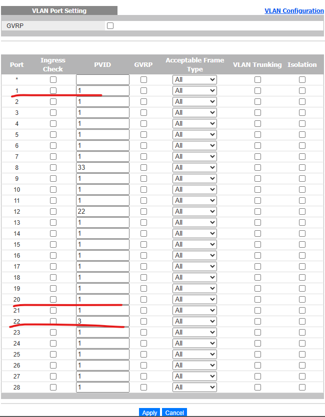

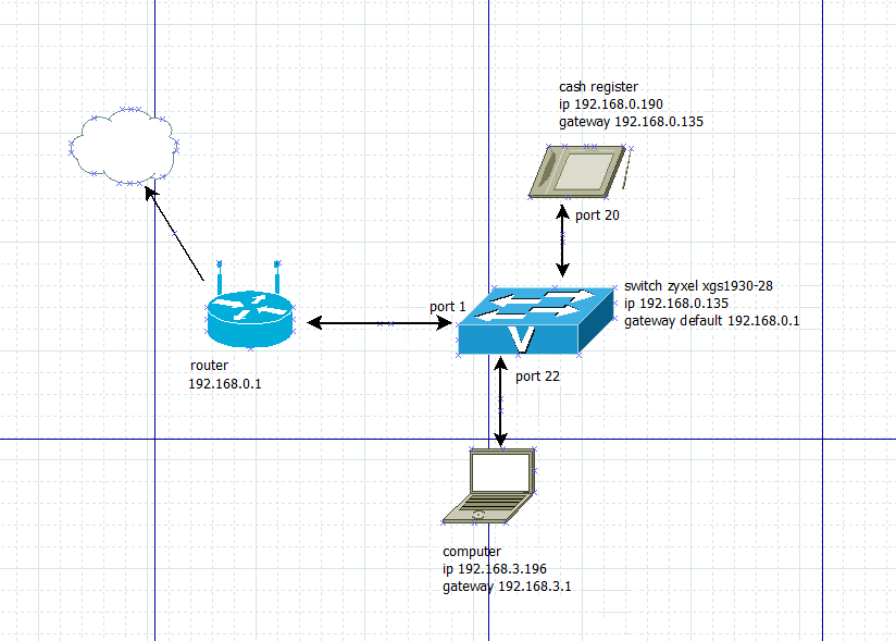

Hi, i'm trying to configure two Vlans on this switch (Vlan 1 and Vlan 3), basically i have a cash register (port 20) and the Router (port 1) in Vlan 1 and my PC (port 22) in Vlan 3, with my PC i can ping the Cash register in Vlan 1 and vice versa it can ping me (of course i can even ping the Switch and access the configurations). My problem is that the Vlan 3 cant ping the Router for some reasons.. no matter what configuration i put in the Static Vlan Setup.

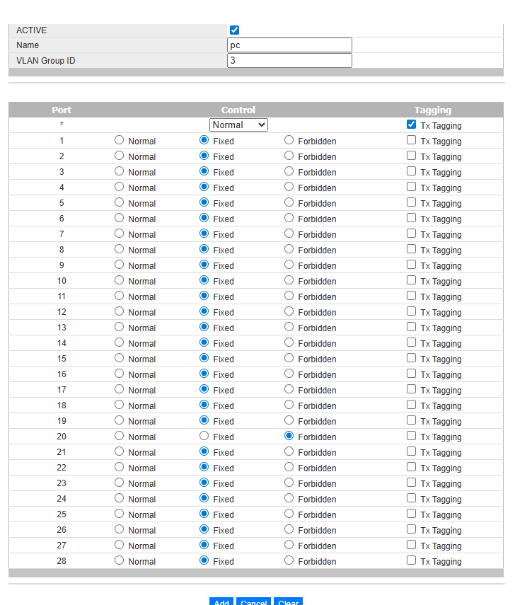

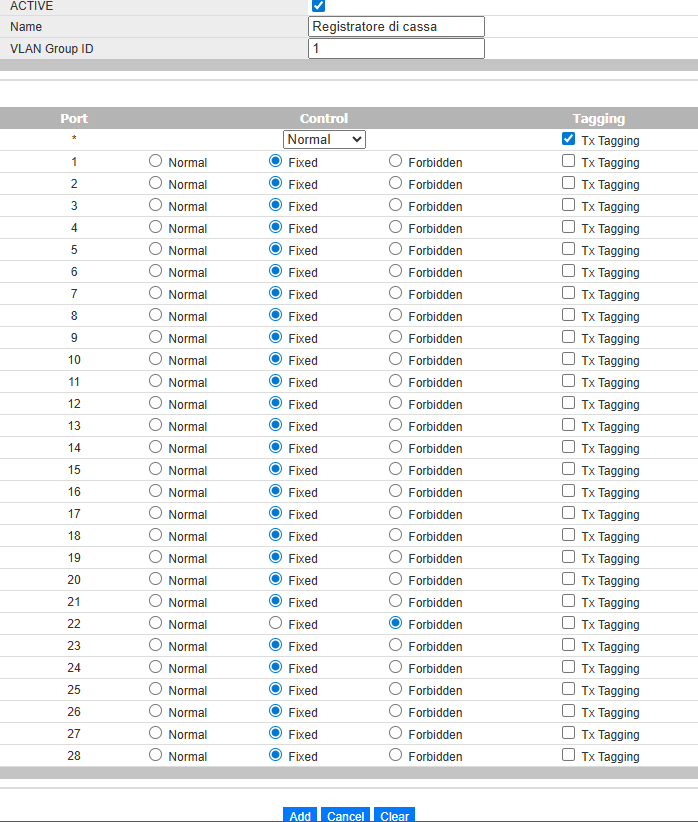

To make the cash register ping, i've put these rules in my Vlan setup in vlan 1 and vlan 3
i've even tried to put forbidden in the port 1 in vlan 3 without success and some other configurations
This is the PVID table:

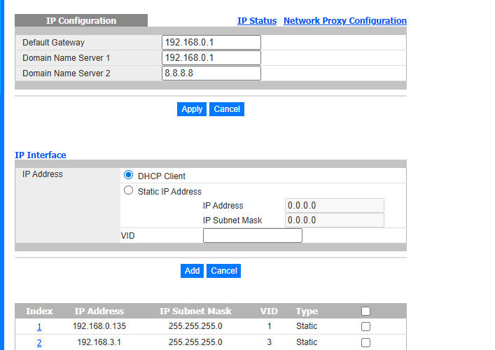

and this is the Switch's IPs

    Do you have the router with VLAN3 and subnet for 192.168.3.0/24? it does not look like you have a VLAN router? but does your router have static routes?
    VLAN3 change all to forbidden but fixed port 1 and 22 PVID looks ok you then want PC with fixed IP 192.168.3.196 gateway 192.168.3.1
    But you need the router to do static routes with destination IP 192.168.3.0/24 gateway 192.168.0.135

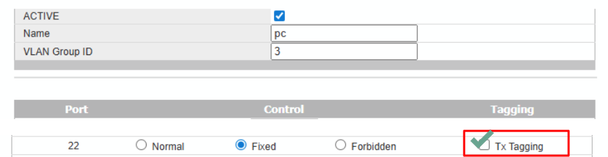

    PC normally does not support VLAN, therefore, you should set VLAN 3 port 22 untagged.
    Also, your router should add a static route rule (details is like PeterUK mentioned), or your router could not know which interface should it send the traffic to.
