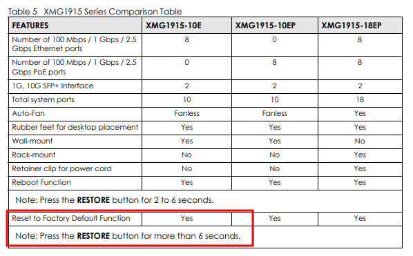

    P.S. Factory default needs to press the restore button for more than 6 seconds.

    Yes, a press restore button for 10+ second

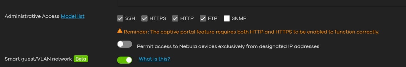

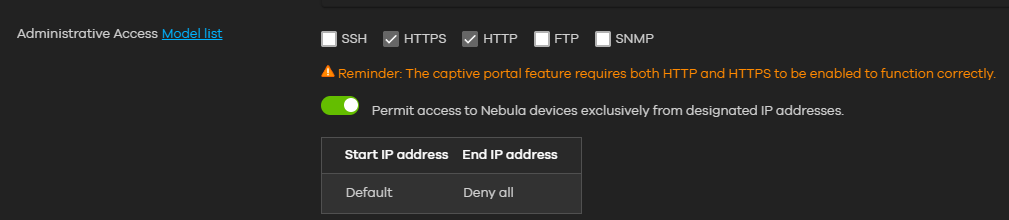

    If the switch did connect to Nebula. It might be possible you have been locked out from local access.
    Please check on Nebula under Configure > Site-Settings if Permit access to Nebula devices exclusively from designated IP addresses is disabled.
    If this setting is enabled the switch will not respond to local access.

    I have it disabled. But i delete switch from Nebula Cloud by removing it in phone app.
