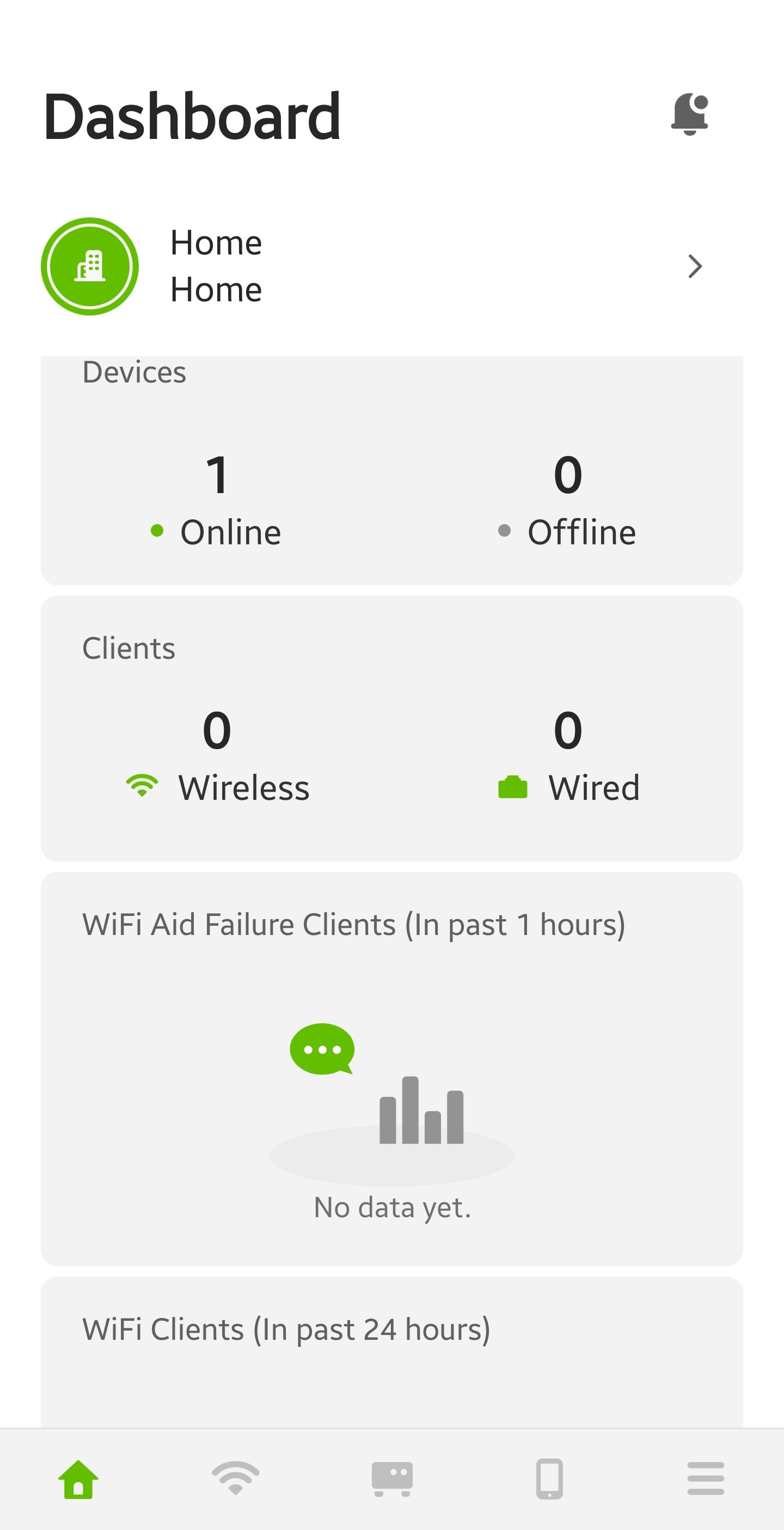

In my NWA130BE with the latest two firmware versions, I have lost the client list.
Everything works fine, but there are no clients.
Firmwares:
V7.20(ACIL.1)
V7.20(ACIL.2)
Any ideas?
Thanks, everyone.

    Hi @DaveM84
    According to the screenshot, it is more likely your AP can't sync the system time with NTP server. With the wrong system time, Nebula could not display the correct current info.
    Please allow UDP 123 for *.pool.ntp.org & time.google.com on your router/firewall.

    Thanks for the replay @Zyxel_Melen
    Bingo! AP log say: "NTP server update failed."
    But don't undestand why …
    The switch use the same *.pool.ntp.org and its work, while the AP fails.
    How can I investigate ?
    Thank you

    Hi @DaveM84
    Please help to enable zyxel support access, we will help to check on this issue. I will send you a private message to confirm your device's mac address so we can find your org.
    https://community.zyxel.com/en/discussion/14234/nebula-how-to-turn-on-zyxel-support-access
    Update:
    Issue fixed by changing DNS server and NTP server.
