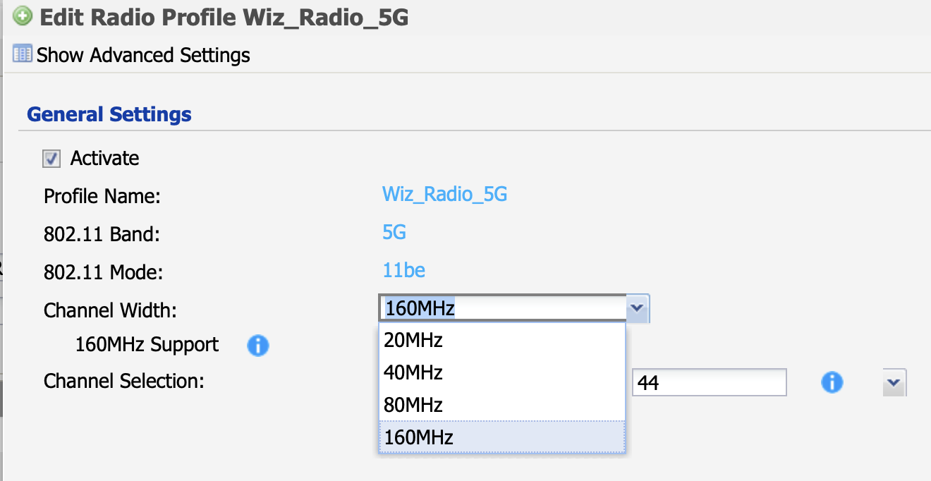

NWA50BE 5G Channel Width limited at 160 Mhz
I purchased the NWA50BE (BE5100) access point. Based on its 5sG network specifications, it should support bandwidth up to 240 MHz, but in the standalone configuration, I see that it's limited to 160 MHz.
How do I set 240 MHz?
Thanks
Hi @GPSoft ,
Thank you for your question about the NWA50BE (BE5100) access point.
You're correct that the NWA50BE supports up to 240 MHz channel bandwidth on the 5GHz radio. However, there are specific requirements to enable this feature:
To use 240 MHz bandwidth, the device requires access to channels 100-144. Specifically, channel 144 is a DFS (Dynamic Frequency Selection) channel that is only available in certain regions due to regulatory requirements.
Regions where 240 MHz is supported include:
- USA
- Taiwan
- Japan
If you're unable to select the 240 MHz option in your standalone configuration, this is likely due to regulatory constraints in your region that don't permit the use of channel 144. The device automatically limits available bandwidth options based on the configured country code to ensure compliance with local regulations.
If you're located in a supported region but still experiencing issues, please let us know and we'll be happy to assist further.
Best regards,
Lynn
0 -
@Zyxel_Lynn I am having a similar issue as the OP, I live in the UK, I believe I setup the router to use UK (I am trying to find a way to confirm that because it's setup as Standalone) but I am unable to see any channels in U-NII-3 band (e.g. 149) which, to my knowledge, can be used here. Can you please confirm? Thank you.
