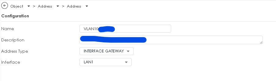

    Object-Address
    Network-Interface
    Internal Profile
    I know I cannot have 192.1681.1/24 in VLAN10 as LAN1 profile has 192.168.1.1/24 in it so that is why I am lost on how this would look. What would I need to change or is this correct? I know I am probably missing something here.
    Thank you.
  • PeterUK
    PeterUK Posts: 4,835
    image  Guru Member
    edited October 2025
    The address object is wrong and needs to be removed in order to remove Native LAN1.

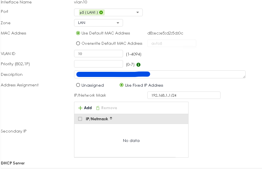

    I am so sorry I am still not following you. I can tell you are the expert, but I might need you to simplify it for me. I am an intermediate user and understand the concepts but trying to understand how the physical interface will associate itself with the new VLAN10 that I have currently setup. The LAN1 profile, which is assigned to Ethernet P5 has the IP Address 192.168.1.1/24. When I disable that profile how would my VLAN10 profile know to route traffic through the physical Ethernet(P5) port without having the LAN1 profile available, which has the physical port assigned to it. It is not about deleting anything or disabling the LAN1 profile but understanding how the config looks without locking myself out, but how the configuration looks. Can you please provide me a small sample config, so I understand it? Screenshots will help out to illustrate this. Thank you very much for your help.

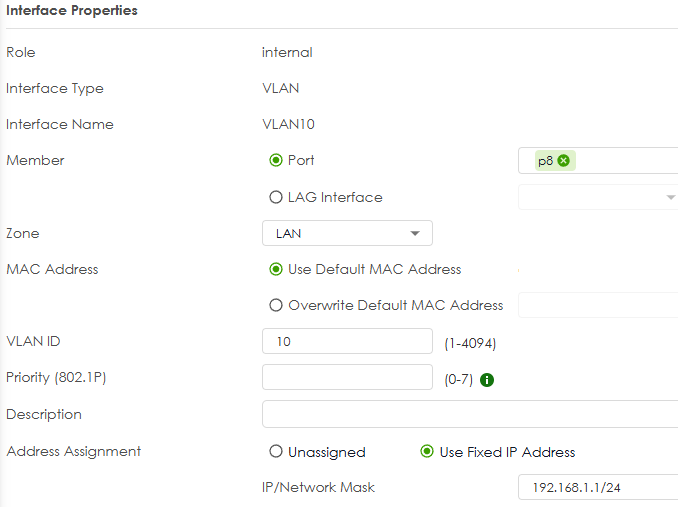

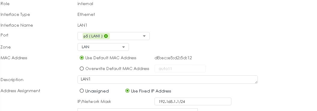

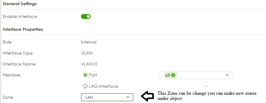

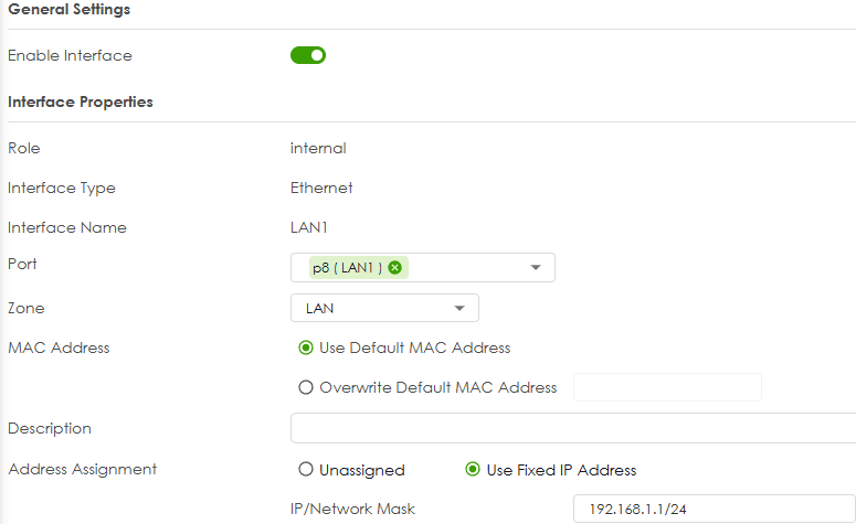

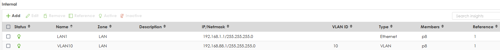

    Ok so you have this (I use P8)
    you then make VLAN10

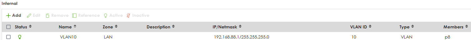

    you have the following
    then login to VLAN10 192.168.88.1 note your switch need to be setup to tag VLAN 10 out to USG

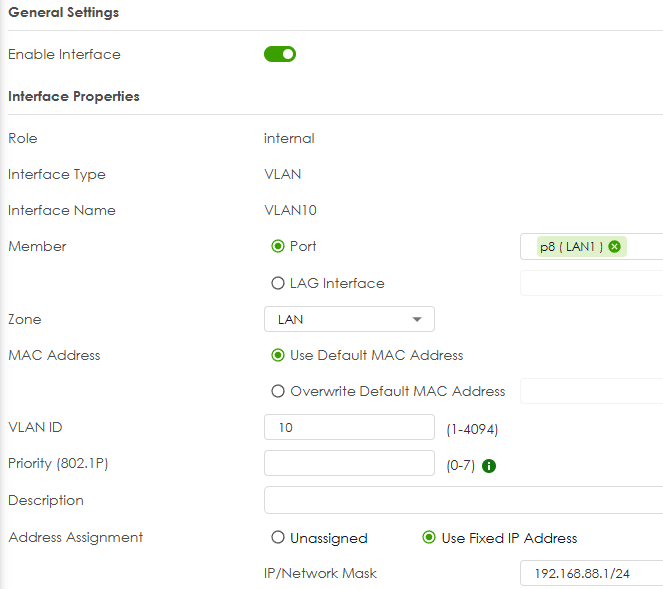

    then you can remove Native Ethernet and have the following
    then set VLAN10 to 192.168.1.1/24

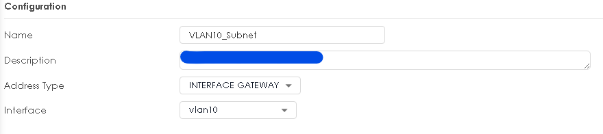

    That is my backdoor to change the VLAN10 to 192.168.1.1/24. Is the below object set right. See below:

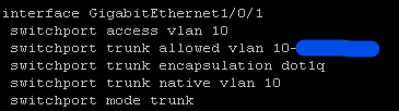

    Here is the configuration of the port that the laptop is plugged into. So there should be no reason why I can not reach 192.168.88.1/24 as my DG for Vlan10. See below:
    This is the port the USG Flex 500H is plugged into. See below:
    This is why I get confused with this firewall. I understand how it works, but this firewall is a little convoluted IMO. Thank you.
  • PeterUK
    image  Guru Member
    What is your switch?
    If you set your laptop NIC to VLAN 10 this will be tagged then connect direct to the FLEX port for VLAN10 and you be able to access it.
