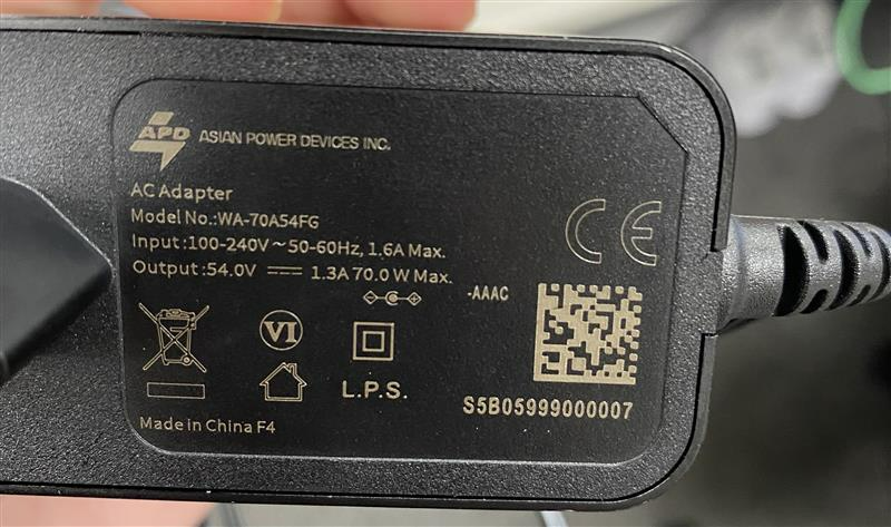

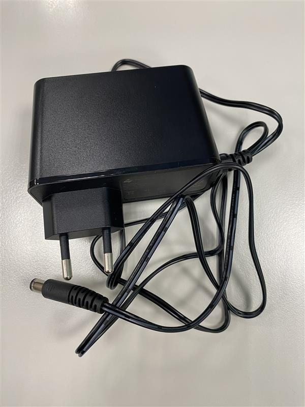

I’m looking to install a GS1915 in a relatively small electrical enclosure. The standard AC-DC adapter is too bulky and with too much cable. For that reason I’m looking to hook it up to a din-rail transformer, but I can’t seem to find any that has exactly the same specs as the standard adapter: 55V - 1.3A. And I can’t find the working range in the devices spec sheets. Can anyone advice on the working range and on what transformer (type/model) from a reputable brand (f.i. Hager, ABB) to use, allowing for full PoE use?

After discussion, our recommendation for operating the switch is to use an AC-DC power adapter rated between 48V and 55V, with a minimum output power of 72W. Please refer to the following example for reference:

Regarding your requirement, please note that using a non-original or third-party DIN-rail power supply is not recommended, as variations in voltage or current stability may lead to PoE devices not receiving sufficient power, potential system reboots, or in some cases, damage to the switch.
Thank you for your understanding.
