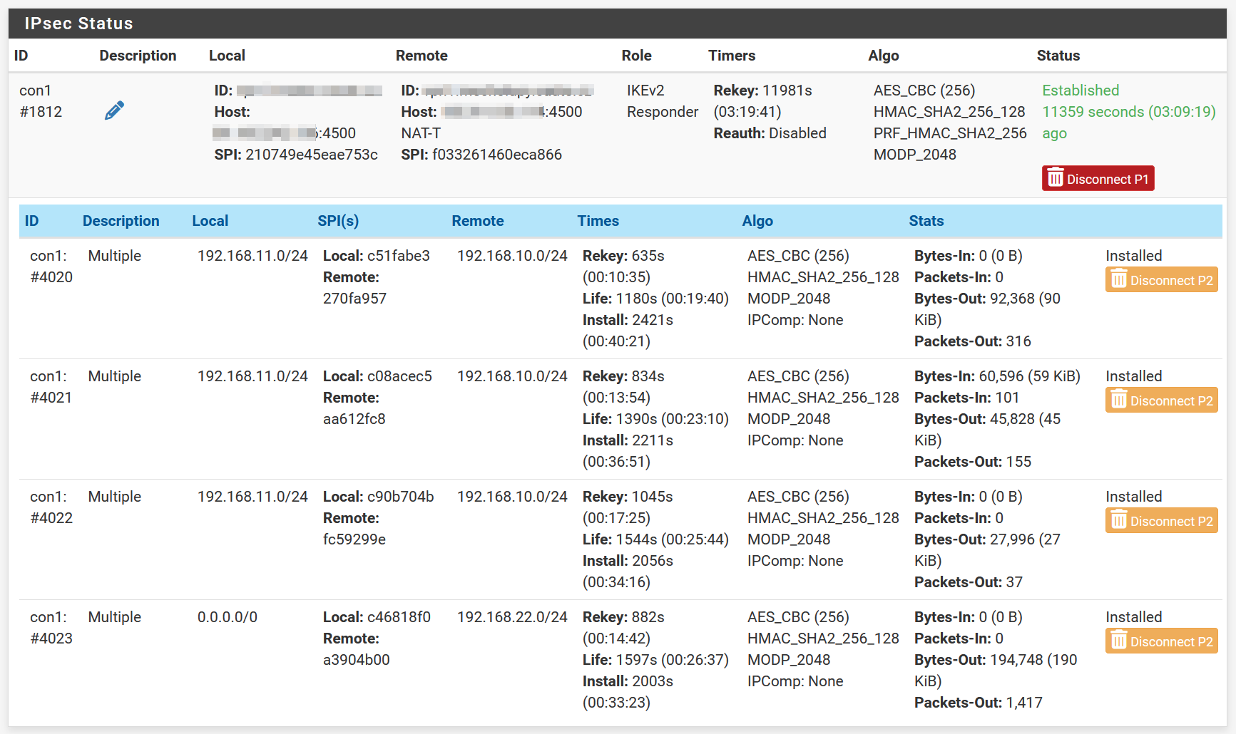

I noticed multiple IPsec connections of a single configuration. It looks like this in the VPN stats monitor:
Why there are multiple connections for the MASTER_VPN_VLAN200 configuration? Any advice is welcome, thank you.

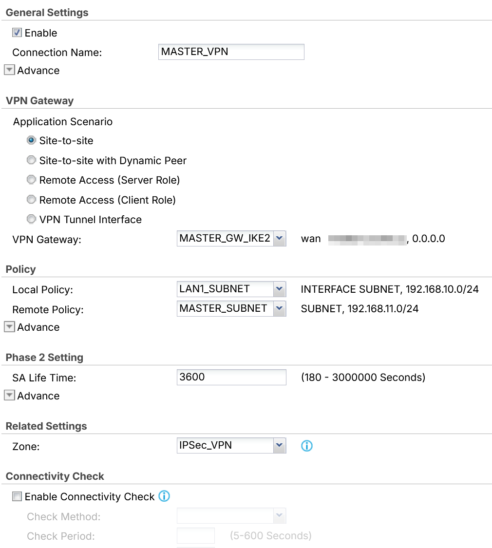

MASTER_VPN:

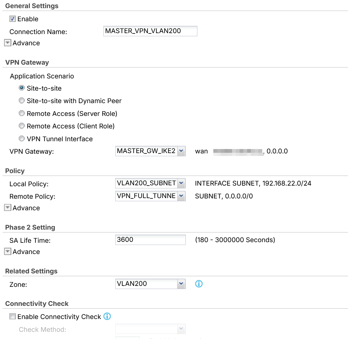

MASTER_VPN_VLAN200:

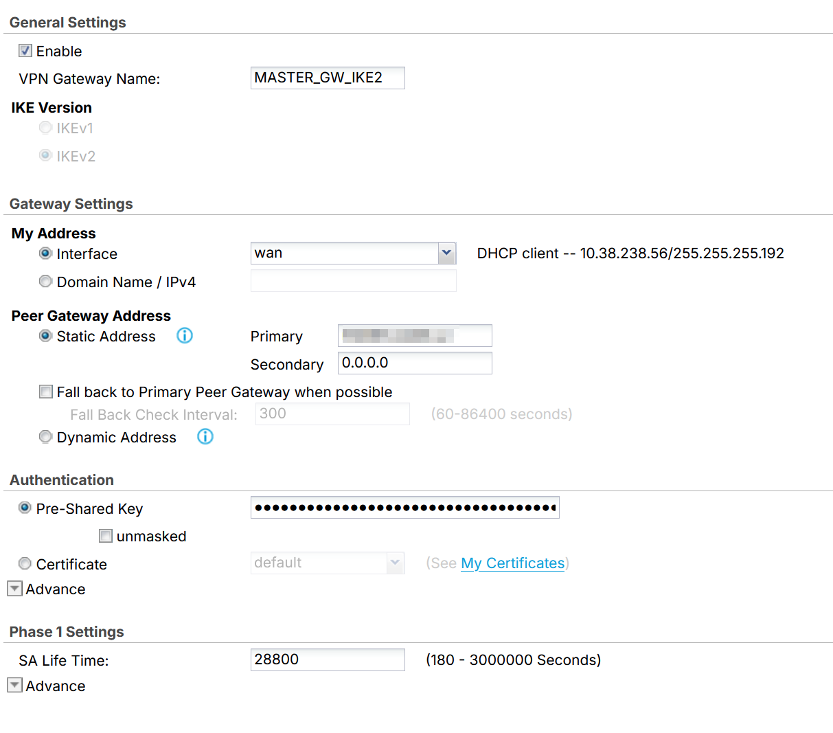

Gateway configuration:
There is pfSense on the other side of the tunnel:

    I think the problem is you have one gateway for the two VPN connections
    If you setup two gateways each with different encryption or local/remote ID for each VPN connection it should work better.
