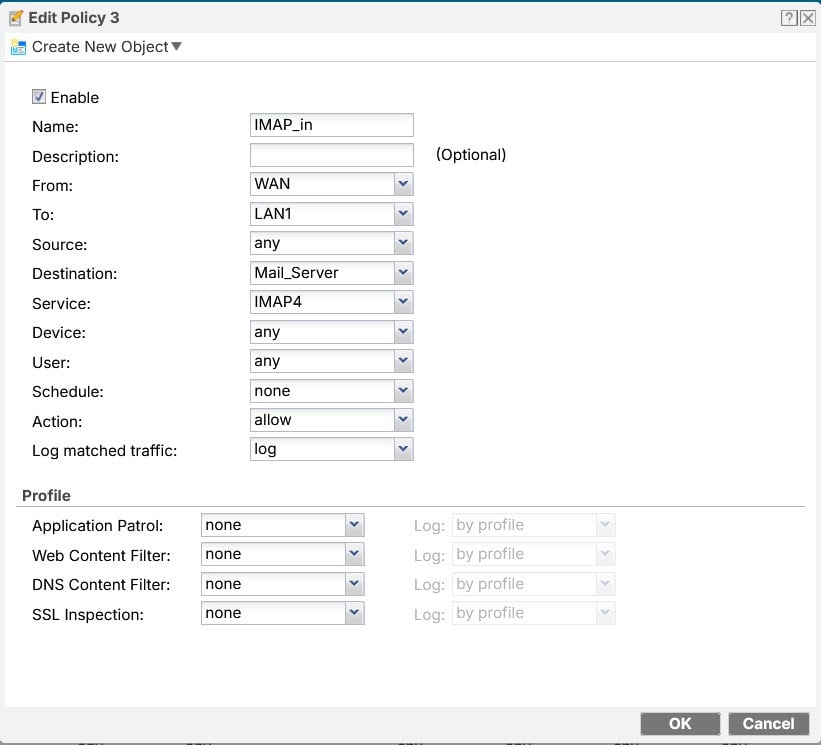

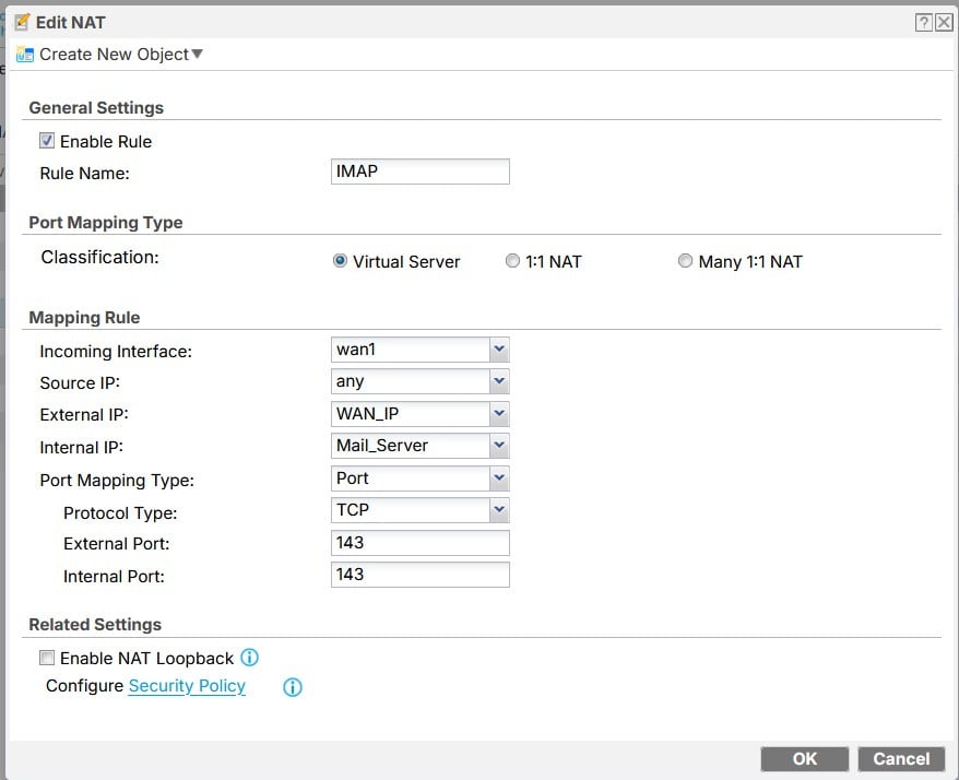

I recently moved from a Flex 100 to a Flex 500, and carefully (I hope) copied across all the settings. That all went fine, with one exception. We run a mail server called VPOP3. Mostly that just serves clients on the local net, but it should also serve external mail clients. To do that I've created a NAT rule which allows external connections to the WAN address port 143 to be redirected to the mail server:143. There's also a firewall rule to let that port 143 traffic through. Setups for the NAT rule and the firewall rules are attached.

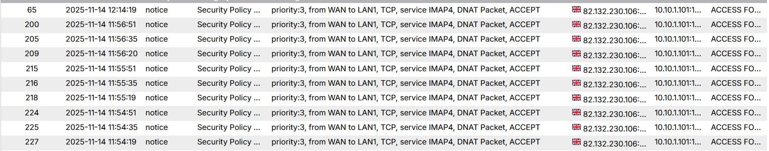

That seems to work, the log shows this:
But the mail server doesn't respond. I had assumed that once a request packet was through the firewall and forwarded to the mail server it would be treated just like an internal request from a machine on the LAN, but that appears not to be the case.

    If it was working fine on FLEX100 the 500 should work in the same way.
    Not sure if maybe you need NAT loopback checked for that NAT rule?
    It would seem that you do if the address to 143 is WAN IP to then loopback to internal mail server.

    The previous router had NAT loopback ticked, and that's how the new one is set also.

    Taking everything at face value everything on the USG is done correct, auto SNAT with use the default trunk which being only one WAN can only go out that one, the TCP SYN should being getting too to server which really only leaves the server to be the problem? unless the sever has no gateway set on it? or some how the firewall on the server is blocking it? or maybe a switch between the server and USG has some ACL MAC blocking which the new USG has a new MAC ?
