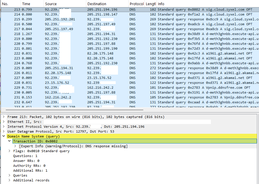

The issue I'm seeing is I have a bind server with WAN IP does lookup from root servers you can see here the from DNS server a DNS query is sent in this case sig.cloud.zyxel.com with transaction ID 0x8082 no reply

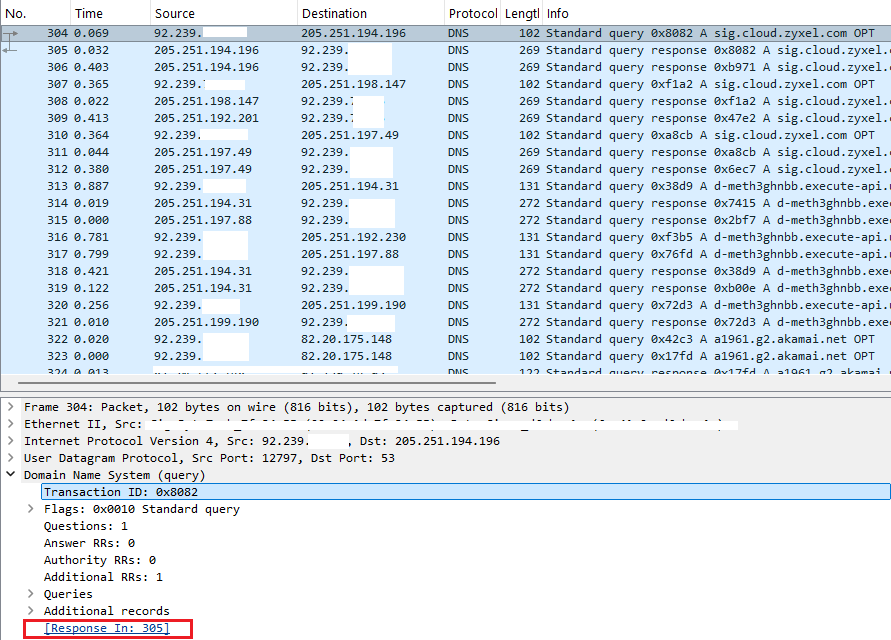

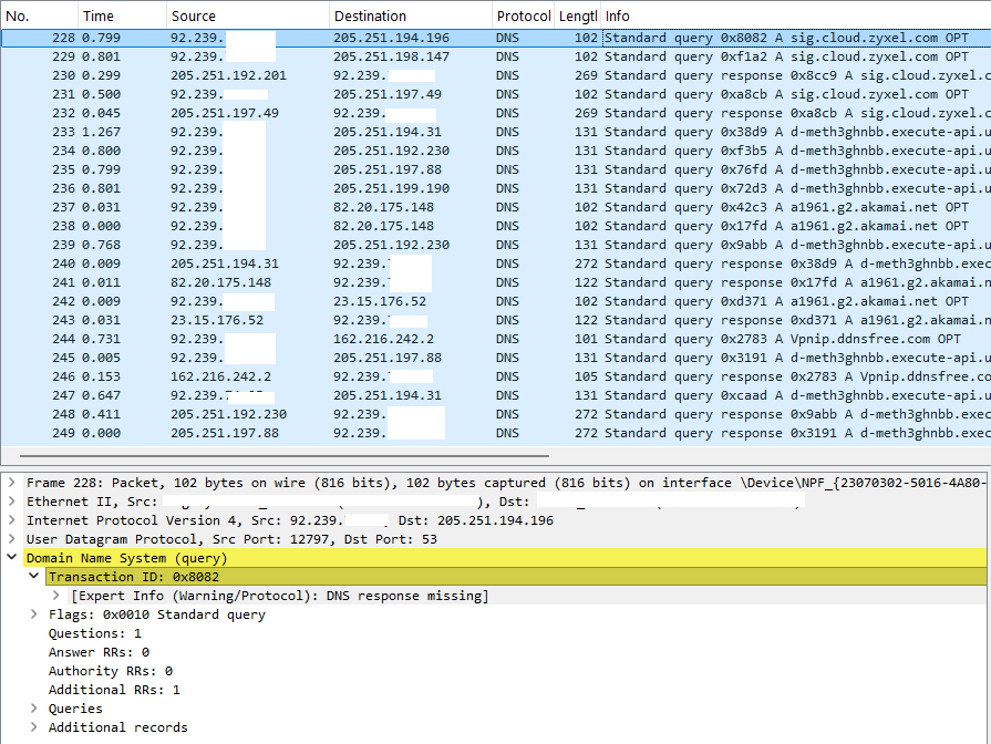

Then a view from DMZ side of the Bridge
Then a view from WAN side of the Bridge which you can see a reply but FLEX200 didn't pass it on over the DMZ

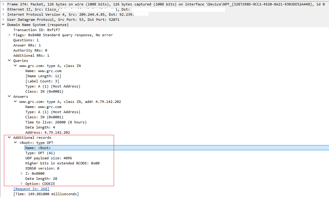

    Update on which might be the issue?
    Bind adds this additional records which USG should ignore when Snooping DNS replies but maybe at times its not doing this correctly?
