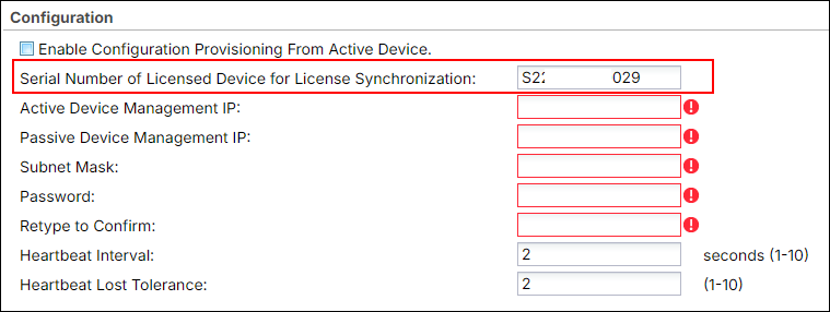

You can check the Device-HA Pro settings page.
There you will find the Serial Number that was configured when Device-HA was first set up. This configuration does not change afterward.
Therefore, you must link the renewed license to that specific firewall serial number shown in the Device-HA Pro settings.
