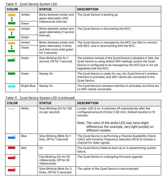

    What pattern of the LED blinking is it? You can check the below table to check the related status.
    Also, could you help to check the PoE mode on your management switch? NWA50BE requires 802.3at mode, please help to check if the switch set 802.3at mode on the connecting port.

    The device was "slowly blinking green on/off for 1 second".
    We figured it out ourselves via the log file that there wasn't enough power (no PoE/at). So you were right with your 2nd suggestion!

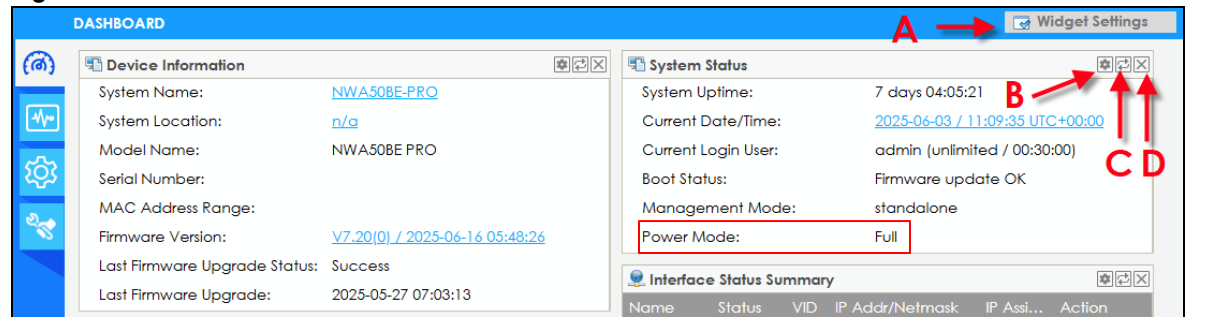

    I would like to suggest that such important information (that the device can also detect and describe, as in the log file) gets displayed in the user interface as well.

    About the display suggestion, you can see the power mode in the dashboard.
    If the device is not using 802.3AT or power cable, it will show limited.
