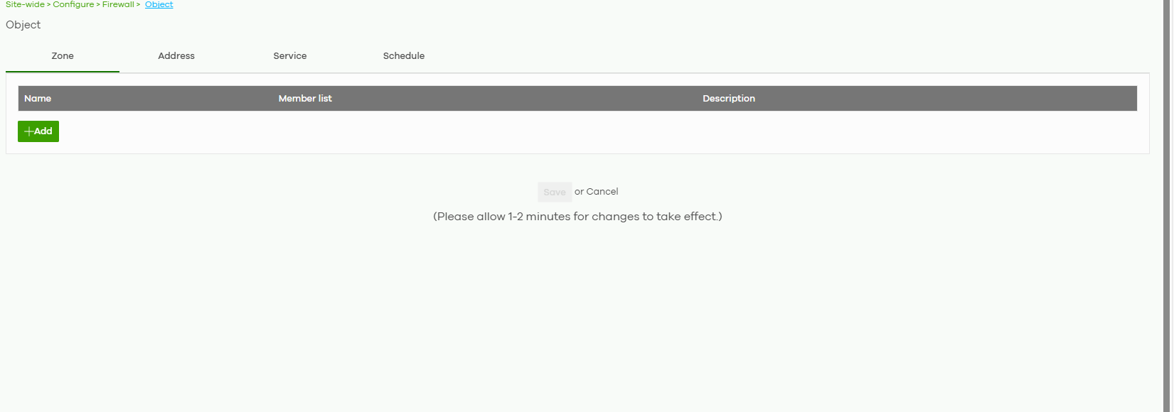

I notice the configuration between nebula and de flex 50hp is not consistent.
i try config override, but the config from the firewall is not transferred to nebula.
but this is absolutely not the case!
while in my firewall zones are configured
