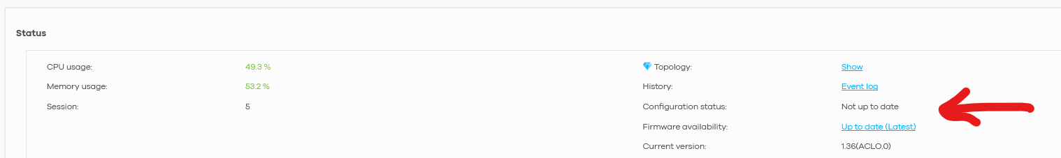

Hello everyone,
I'm setting new firewalls from H Series and I'm waiting for a lot of time that they sync with Nebula.
I see this:
Is it possible to make the sync as quick as possible?
I'm waiting for about 30 minutes instead of 3 mins.
Also online it is saying that the firewall it NOT up to date:

    Hi @GiuseppeR,
    Thank you for providing the information!
    The "not up to date" status can occur when a configuration setting exists on one side but is restricted or unsupported on the other end. This prevents successful config synchronization and can cause the device to remain stuck in the "Applying Cloud Configuration" state.
    After checking your sites, we found the status is now up to date. To investigate further, could you please confirm if any configuration changes were made while the device was applying the cloud configuration? In addition, could you provide the approximate times when you saw the "not up to date" status and when it returned to "up to date"? This information will help us check the logs and determine what happened during the issue.

    image  Zyxel Employee
    Hi @GiuseppeR,
    Regarding the slow synchronization you're experiencing, we would like to clarify that NCC operates with a specific fail-and-retry mechanism. If configuration changes are made during the sync process, it can trigger a failure. When this happens, the system waits for the next scheduled synchronization round, causing the delay.
    To ensure a smoother experience, we recommend allowing the device to complete its initial sync fully before making further configuration changes.
    We appreciate your understanding :)

    Hi @GiuseppeR,
    Regarding your question, the NCC system is scheduled to synchronize every 15 minutes.
    If a configuration sync fails or is not fully completed, the system will automatically trigger a retry in the next 15-minute cycle. Therefore, the expected interval for the fail-and-retry process is 15 minutes.
