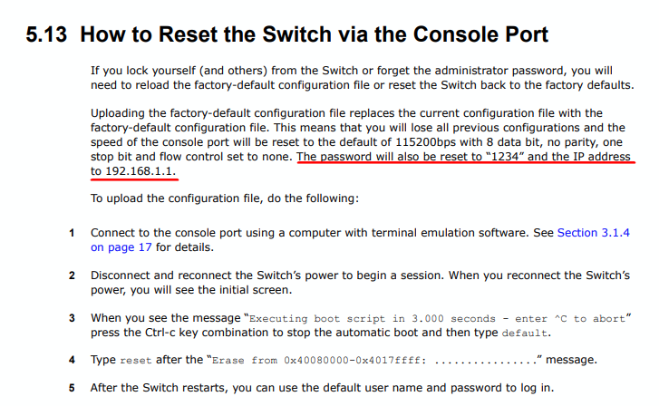

We’ve checked our firmware package for the GS1910-24HP. It only contains the standard .dat files and does not include a ROM recovery image. Since this model has already reached End of Life, we’re only able to provide limited support.
Please try the procedure described in the User Guide under “How to Reset the Switch via the Console Port” section to recover your device:
If the issue persists and the device cannot be recovered, we’d recommend considering our current switch models as a replacement. We appreciate your understanding.
