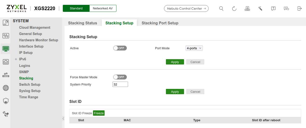

Q:
How to change the stacking port mode when the switch is already in stacking mode?
A:

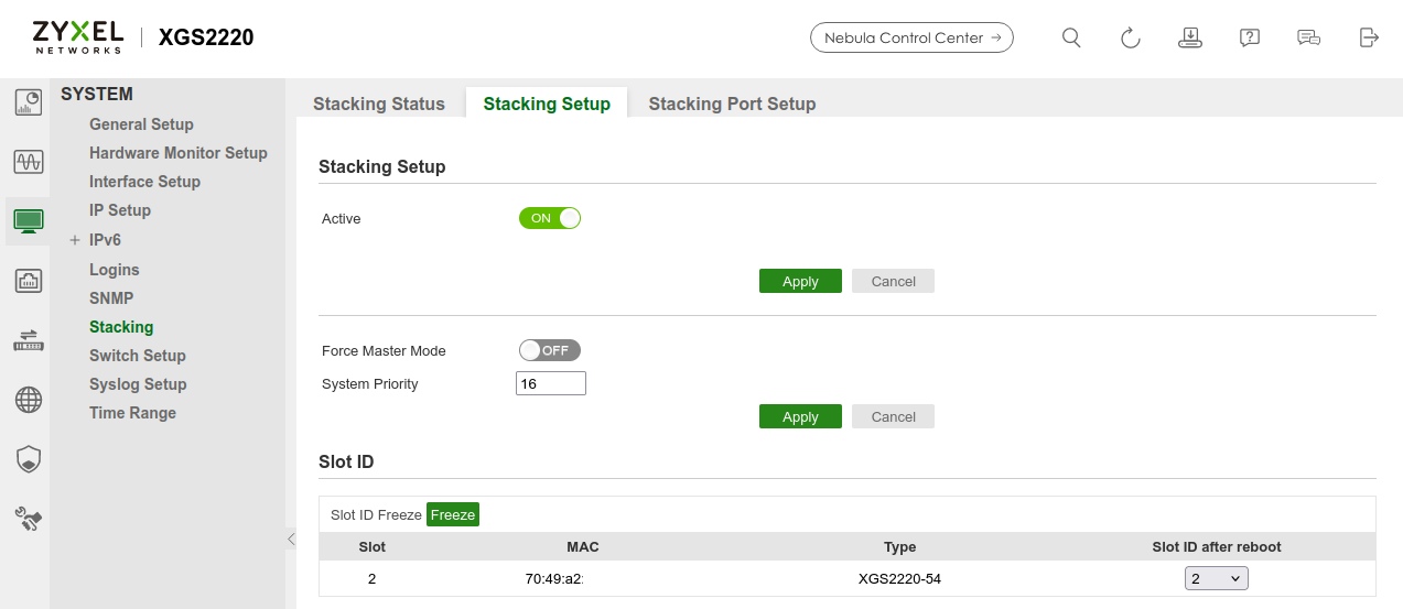

When a switch is operating in stacking mode, the port mode option is intentionally hidden. This is because the port mode directly affects the stability and reliability of stack communication.
To change the stacking port mode, it is recommended to:
  1. Factory reset the switch.
  2. Select the desired stacking port mode before switching to stack mode.
