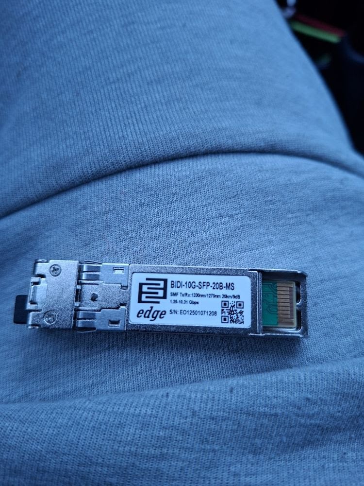

The fiber optic is being connected at the end of the month and I bought XMG-105-
ZZ0101F.
I get a module from the network operator and they suspected that Zyxel does not work with this.
I have 20 days to return the purchase if it does not work and the functionality cannot necessarily be verified before the return date expires.
Here is the pic of the module.

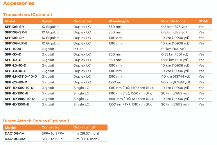

    Hi @L4mppu
    ZYXEL switch products are recommended to be used exclusively with ZYXEL brand modules to ensure optimal performance and reliability.
    Using modules from third-party sources can potentially lead to decreased network performance and reliability, such as packet loss and connectivity issues, which also cannot be guaranteed by ZYXEL. ZYXEL may not offer technical support for networking issues that are identified as being caused by IOP with third-party modules.
    In addition, the BIDI SFP module can't use same Tx/Rx module on the two connecting devices. For example, one device uses 1310 Tx/1490 Rx module, the other needs to use 1490 Tx/1310 Rx module.
