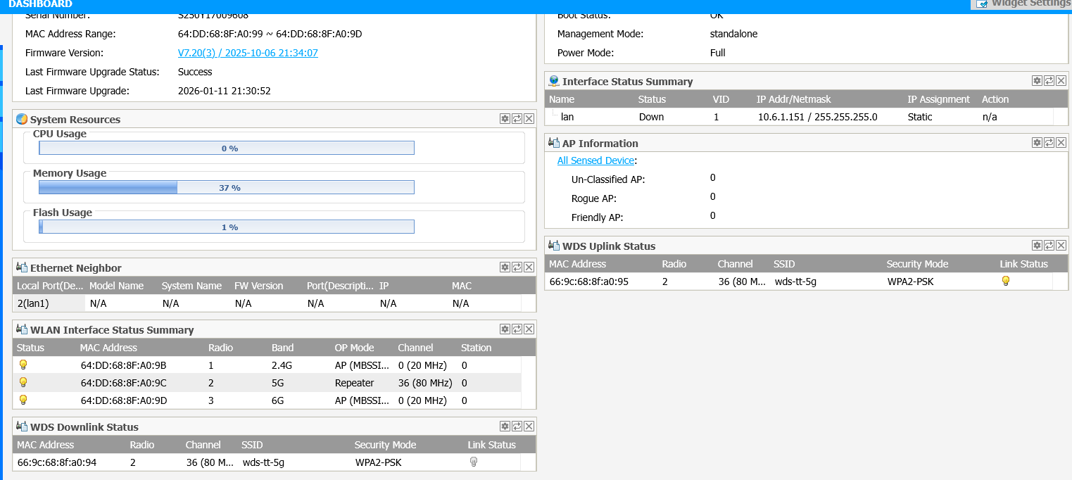

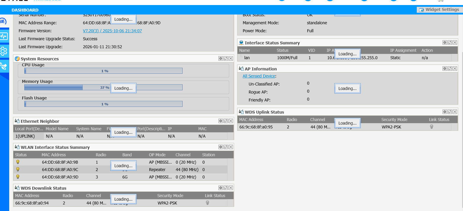

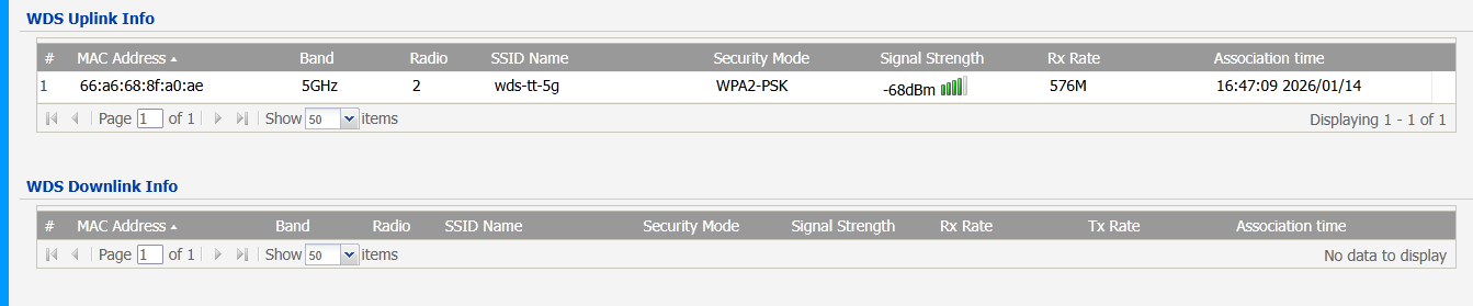

  • howax
    howax Posts: 4
    image  Freshman Member
    edited January 15
    Hi @Zyxel_Melen
    Thanks for your reply.
    In answer to your questions:

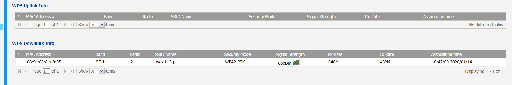

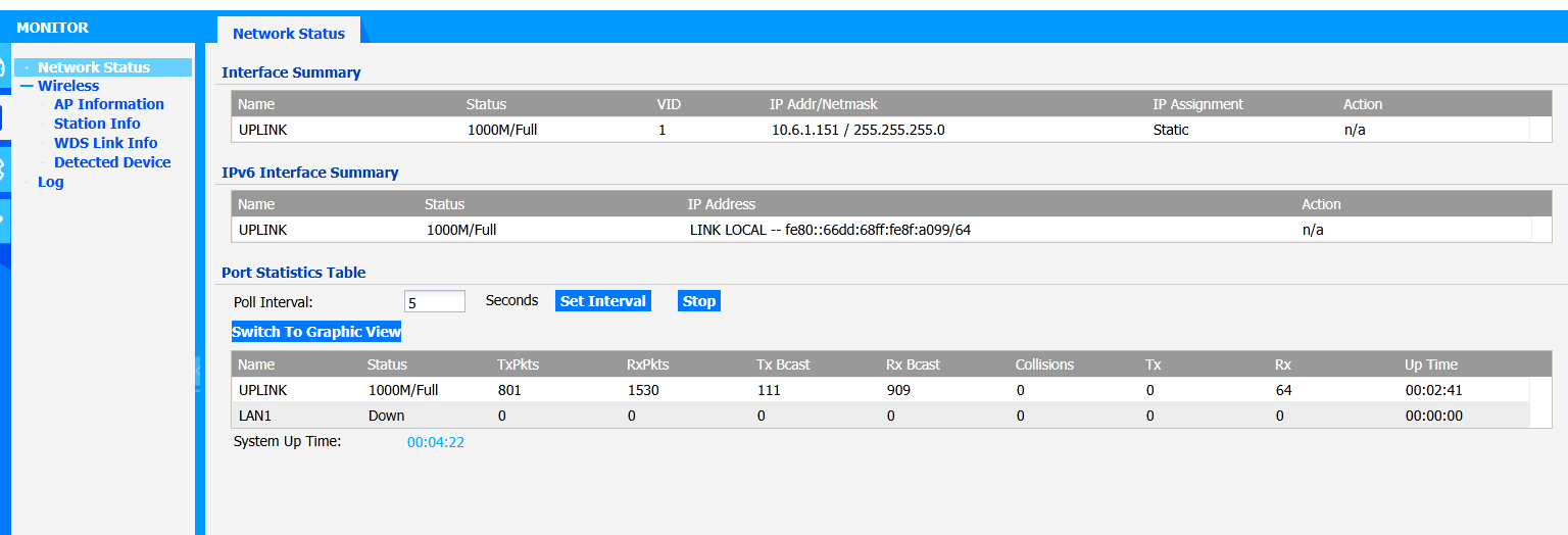

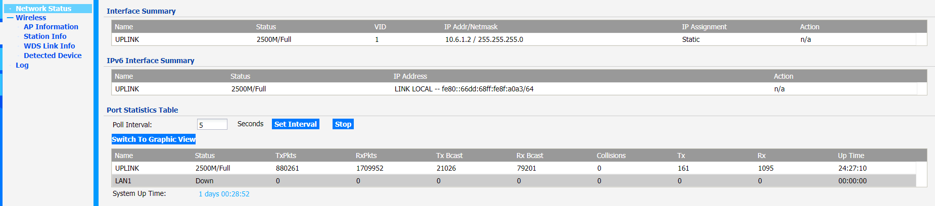

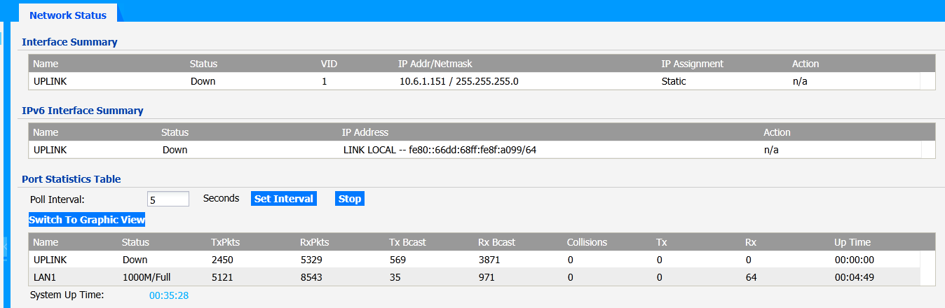

    1. After configuring the WDS link on radio 2 (5G), the root AP can see the repeater. However, as soon as the link is established the UPLINK i/f on the repeater goes down and I have to switch the PC connection from the IN port of the injector to the LAN1 i/f of the AP. I can connect to the root from the PC connected to LAN1 on the repeater but I cannot connect to the repeater from the PC connected to the wired network at the root AP. I was able to do this before I upgraded the f/w.

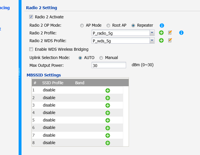

    2. Wireless bridge is not (and has never been) enabled at the repeater - I do not need nor intend to use this feature at this time.
    Unfortunately, I did not make a note of the f/w version prior to upgrade but I have a hunch it may have been 7.15. I have attached a number of screenshots which go some way to illustrate the behaviour - filenames including pre are before the WDS is configured and established, those with post are after configuration and all include a date and time (GMT). If you need more information, please let me know and I'll do my best to help.
    Many thanks
    howax

  • howax
    howax Posts: 4
    Hi @Zyxel_Melen
    Thanks for your reply and for attempting to reproduce my problem.
    All of the devices are on a single network n.n.n.n/24, no subnetting. I'll include details in the private message.
    For these tests I have positioned the root and repeater less than 1 metre apart. I can ping the repeater from a client wired to the LAN1 port of the repeater but not if it's connected through the PoE injector to the UPLINK port. I am unable to ping the repeater via a wireless connection to the root AP and neither can I ping the root from the client connected to the repeater. The repeater currently has no active SSIDs configured - I'm just trying to get the WDS working again.
    Thanks very much for your help - I'll send the diagnostics to you in a private message shortly.
    howax
    PS Yesterday I used the CLI to attempt to bring the UPLINK i/f up manually but none of the commands I used recognized any of the i/f names I used.
