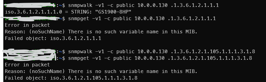

    Model: GS1900-8HP
    Firmware old: 2.00(AAHI.0)C0_5
    Firmware new: V2.90(AAHI.1)C0
    Screenshot from using snmpget and snmpwalk under Debian.
    What is interesting: The first query with snmpwalk succeeds on the very basic OID. With snmpget it fails. I also use MIB Browser under Android. There it is similar, i.e., when browsing, most OIDs are read, but when polling, an error occurs.
    I already tried to disable and reenable SNMP on the switch. Changes nothing.
    Can you tell me, which MIB file the PoE enable/disable OID is described in?
  • Zyxel_Melen
    Zyxel_Melen Posts: 5,145
    image  Zyxel Employee
    Hi @michiba
    I just test in my lab and get the same result as yours with the latest firmware version. Let us check what was changed and update to you.
    Zyxel Melen
