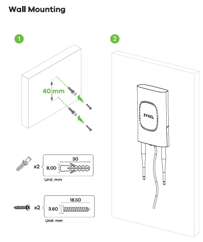

    Regarding your question about mounting accessories for the NWA55AXE, please refer to this post where Zyxel_Barry has already addressed it:
    No additional accessories are required for wall installation. The NWA55AXE includes wall-mount screws in the box, so you can directly fix it to the wall and hang the AP.
    For pole mounting, Zyxel does not provide dedicated hose clamps. These depend on your pole's diameter and are typically sourced locally.
    In short: wall-mounting is supported out of the box, and pole-mounting only needs general-purpose hose clamps—no Zyxel-specific accessory code is required.

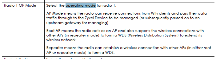

    It's important to note that the NWA50AX Pro, which you considered for the client side, does not support wireless bridge functionality. You would need a different model for the repeater AP. Refer to Zyxel's device function table to confirm compatibility.
    According to the device management, I have these option
    Page 129 of the user manual
    Page 152 of the user manual
    Therefore this AP should connect to the other one.
    Also: this AI answer does not actually provide any alternative suggestion for the client AP.
    Last but not least: how does the part "Nebula" matter with a mandatory forbade from the customer to use Nebula?
    This automated answers are useless

    Which is the code for optional mounting accessories for NWA55AXE?
  • Zyxel_Tina
    Zyxel_Tina Posts: 1,028
    Zyxel Certified Network Administrator - Security Zyxel Certified Network Administrator - Switch 250 Answers 500 Comments
    image  Zyxel Employee
    Answer ✓
    Hi @mMontana,
    Thank you for sharing your detailed considerations.
