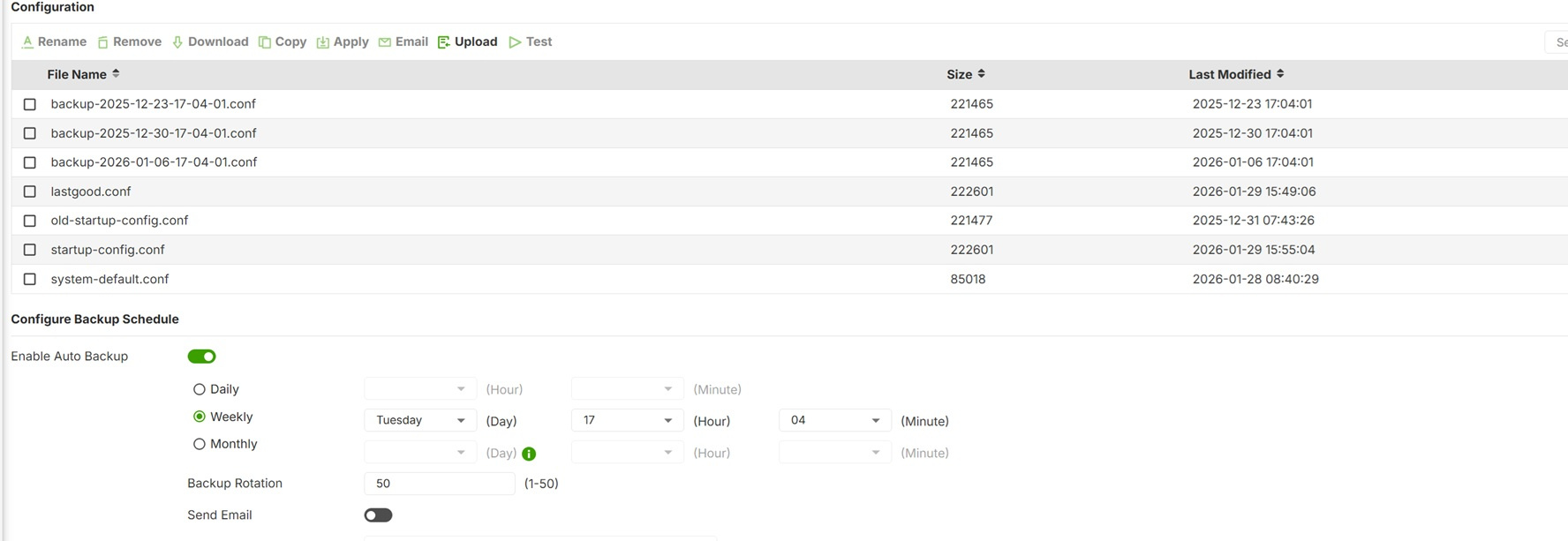

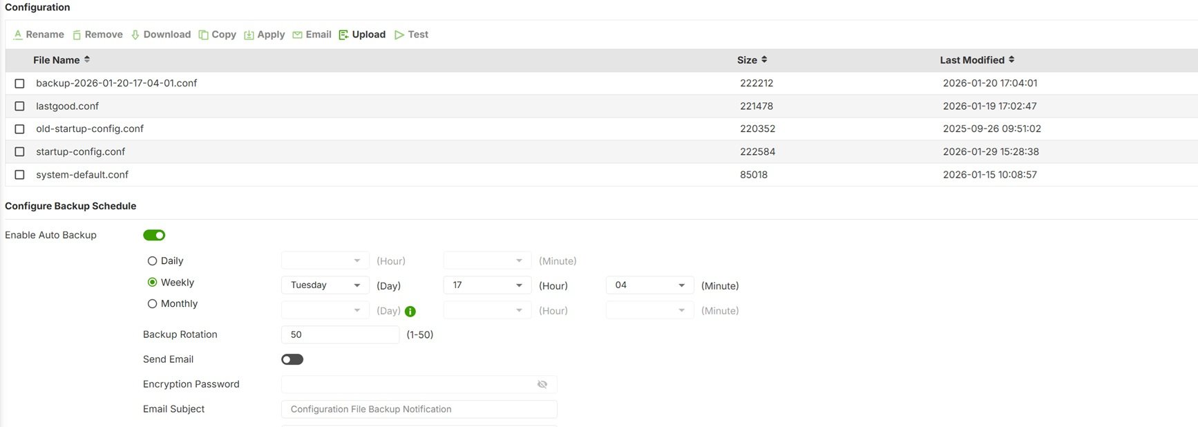

When the device configuration backup is set, after each device update to a higher version, the same with 1.37, the last backup files before the update are deleted and suddenly files from several months earlier appear that were not visible in the window before the update, e.g. from September 2025.

Unfortunately, I can't take before and after screenshots. Maybe next time with the new version. My backups are set to weekly. Rotation is 50. After the update, should the system show current backups from before the update? The system is currently deleting them, which may be why it's showing the old ones?

do you see?
Configuration (Standby Partition)
as you can download the startup-config.conf that was the last config when the firmware updates to the Standby slot to then become the running slot.
Do the following if not showing
How to display the standby firmware partition on GUI? — Zyxel Community
0 -
