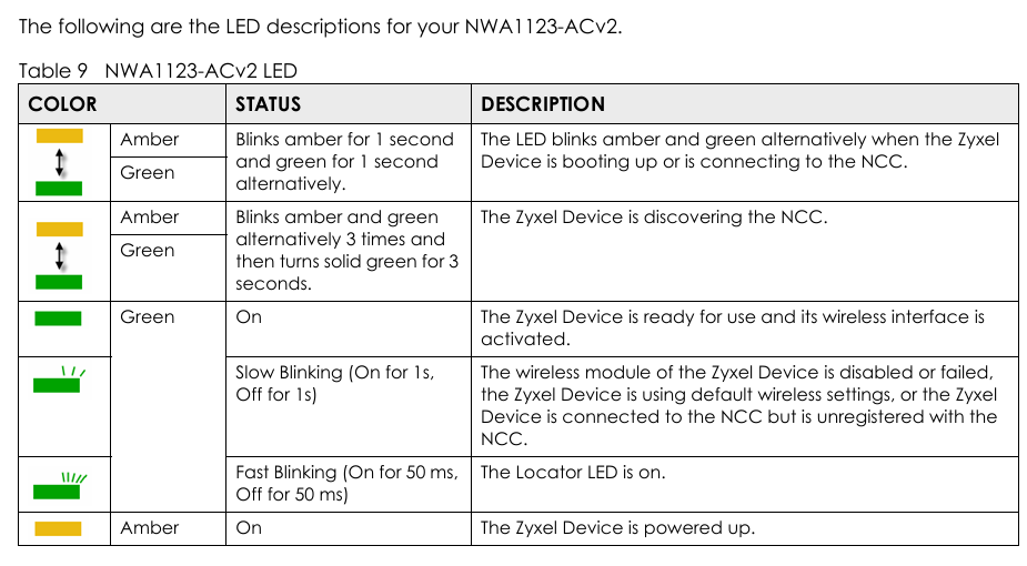

    Hi @Pablodecuba,
    Welcome to the Zyxel Community!
    Regarding the correct LED behavior, please refer to the screenshot below. If you are encountering the first LED pattern (amber and green blinking for 1 second alternately), please check whether the AP is connecting to NCC. If it is not, the device may be stuck in the boot process, in which case you may need to contact your local support for RMA assistance (if applicable).
    Please note that the NWA1123-ACv2 has reached to its End-of-Life (EoL) status, which means our support for this model is now limited. For better performance and ongoing support, we recommend considering our current AP offerings here: Wireless | Zyxel Networks

    Hi @Pablodecuba,
