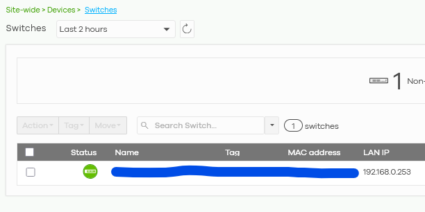

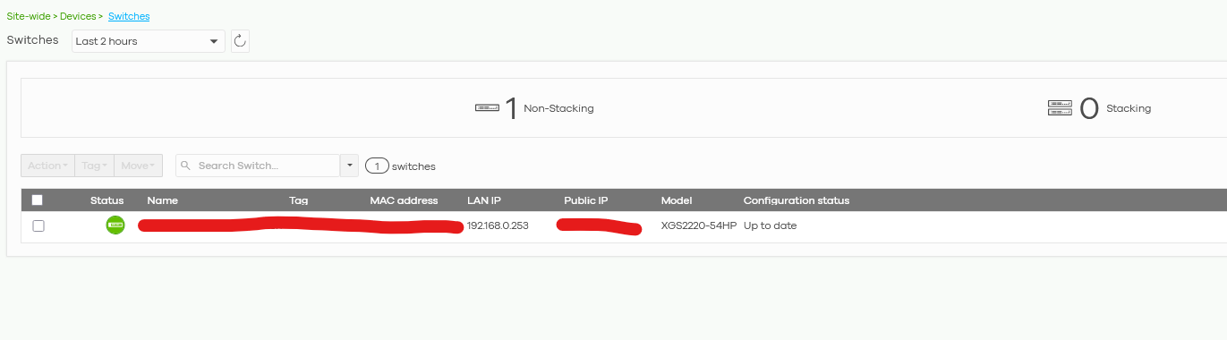

on a site I decided to assign 192.168.0.250 to a switch but it became unreachable.
So I gave it the x.x.x.253 IP and now I can see it:
The problem is that the firewall does NOT show me the fact that x.x.x.250 was already taken using the On-Premise UI:

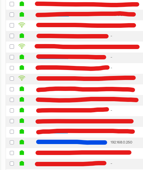

So I verified it via Nebula and there I see something using x.x.x.250 IP:

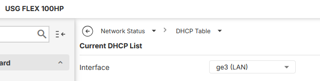

    What you checked is the DHCP table, which only records the DHCP clients. To see the clients with static IP on local GUI, my current method is to enable the device insight function in system > advanced > Additional feature and check in Network status > Device Insight.

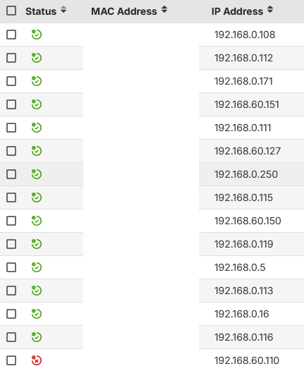

    So I checked "Device Insight" and I see that something is using 192.168.0.250:
    So I went to check all those IPs ordering them by Online Status, as you can see this image should group everything that is active and inside my network (like a free IP Scanner should show me….) but the reality is NOT like what the H series shows me:

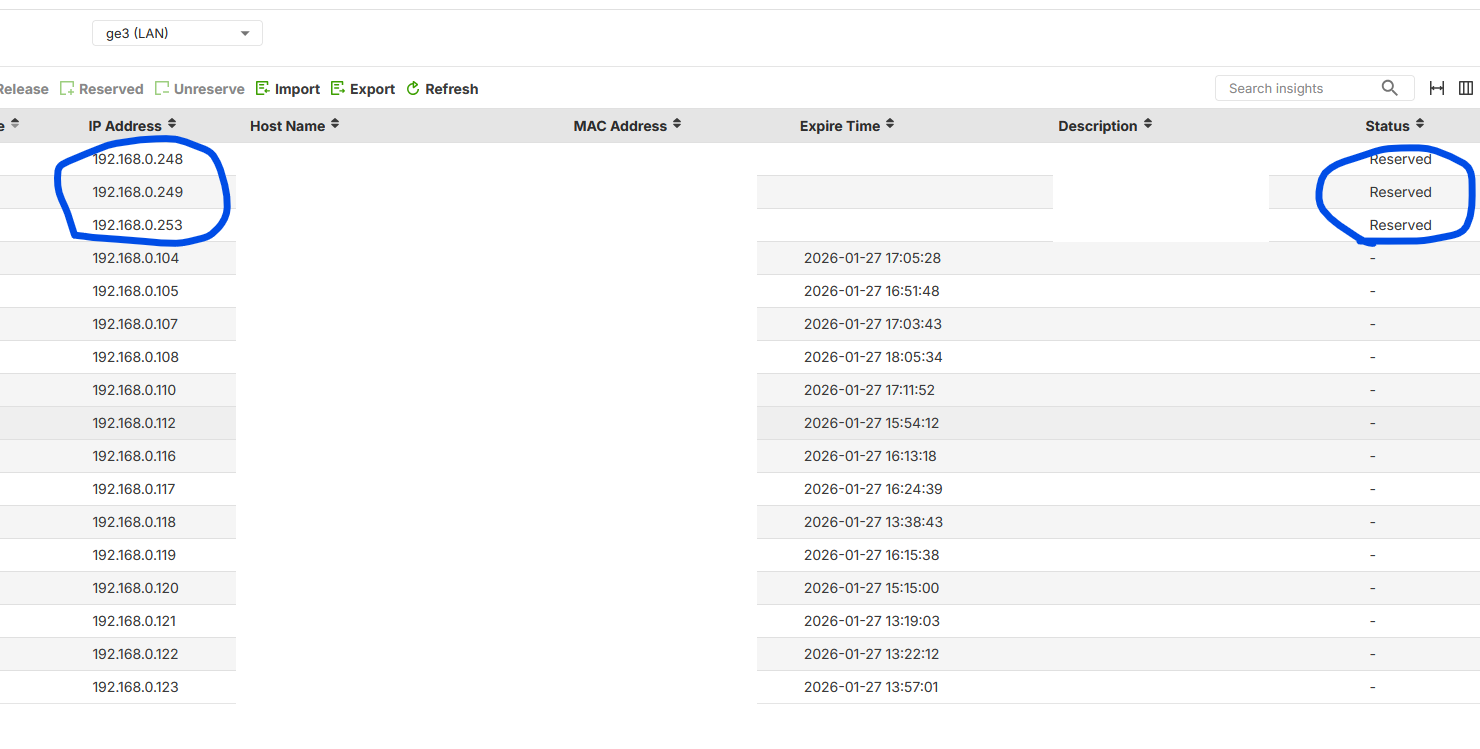

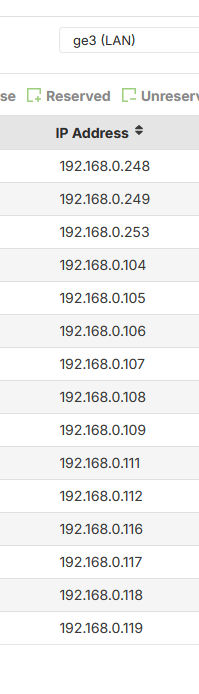

    Comparing also to my list of reservation:

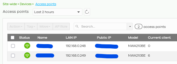

    I read the "Device Insight" list and I miss at least 3x Zyxel devices that are online and active inside my network.
    To be exact 2x APs:

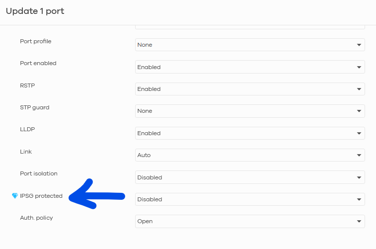

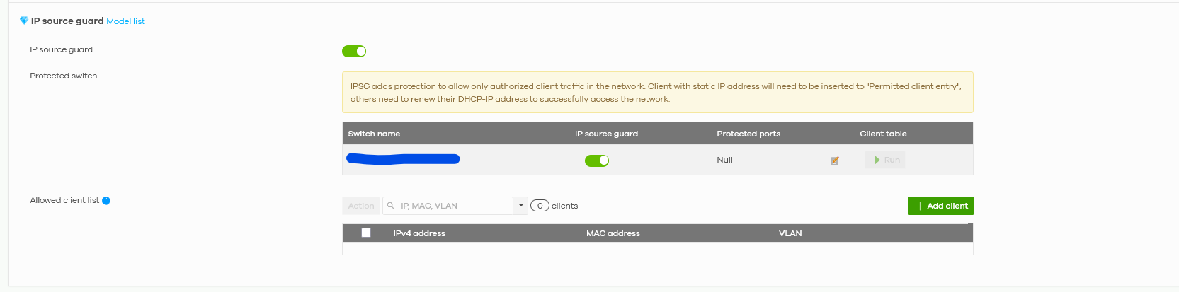

    Then I went to check IP Source Guard:

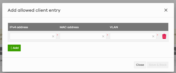

    And the Nebula requires me that I have to select witch port I have to protect:
    And then manually (!) insert each value one by one:
    Considering that IP Source Guard is NOT always available (e.g. you install Zyxel firewall in a network managed by old switches) the firewall remains the ONLY platform where to declare a reservation for IPs.

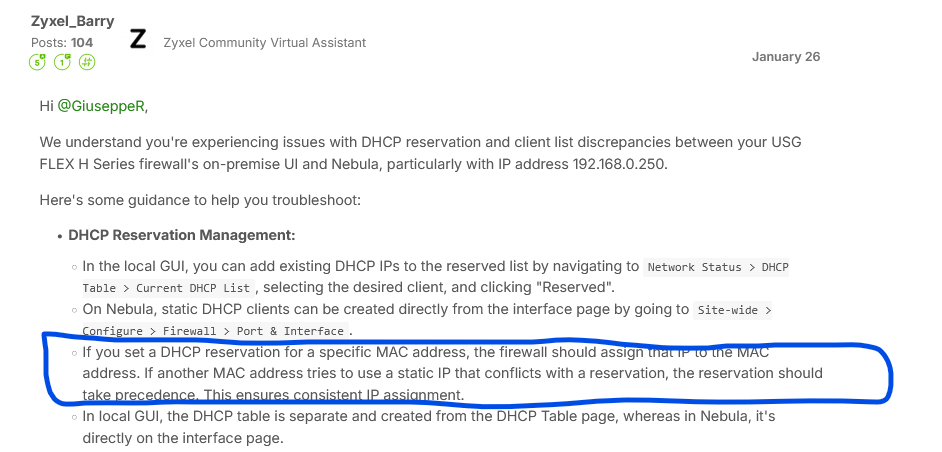

    Please consider that @Zyxel_Barry is confirming my idea:
    Otherwise I could have critical violations and/or I have to spend huge amount of time armoring everything inside the network, not all the Clients have that amount of budget to be spent on these high end appliances.

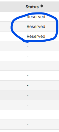

    A part from this, I think that the DHCP table:
    should show the complete IP list considering the reserved ones (like the screenshot above) and the static request ones, maybe higlighting them with a specific term in Status column:
    For example showing "Reserved" and "Static" to make a clear difference with the IPs obtained via DHCP.
