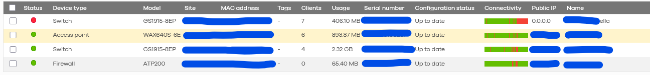

If I have the ISP connection down one of them is really slow to come up to Nebula again when ISP connection is restored:

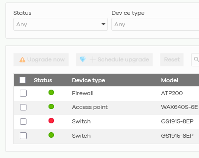

As you can see one of them is green while the other one is RED.

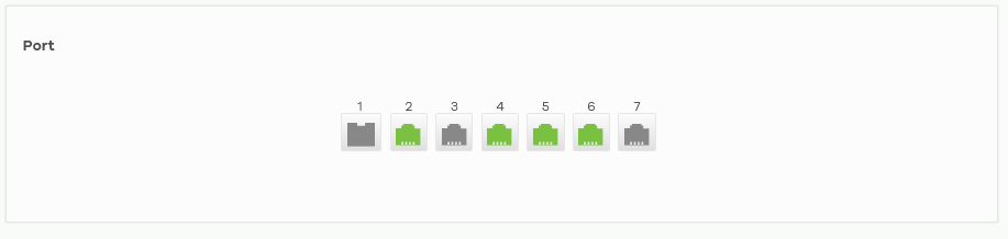

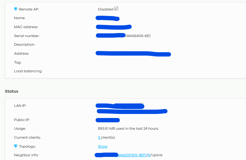

Please consider that the AP is linked via PoE+ to the RED one, so on the red one the internet link is properly working (AP is green and linked to port 6, see below) and the PCs linked to the red one are on internet too:
The issue is related only to Nebula connection on that switch, as you can see it is offline since too much time:
How can I fix that?

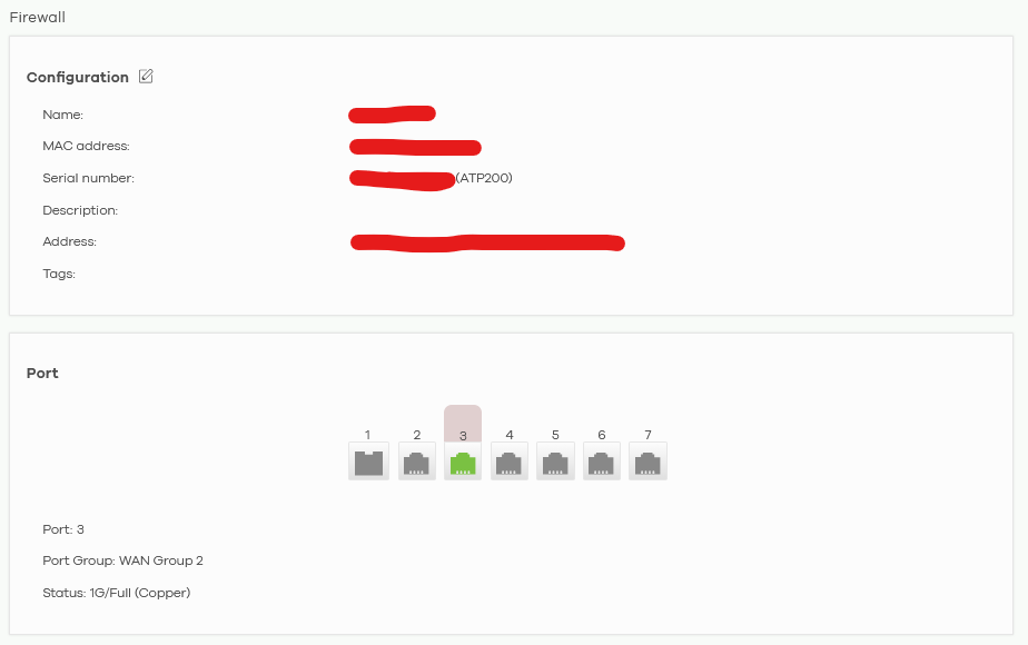

    Anyway the error that I see remotely is that the firewall has connected only the WAN2:

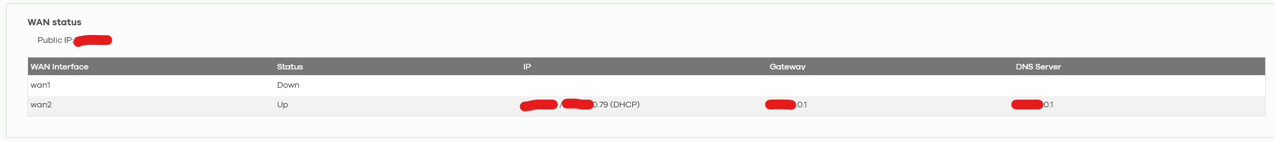

    And that WAN2 is connected to the DHCP server of the ISP router:
    So the same ISP router is giving IPs to all of the rest of the network, included the ATP200: it seems impossible to me that the firewall is leasing something via DHCP to the rest of the network because its LAN interface is down.

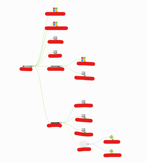

    I linked both Zyxel switches directly to the firewall:
    If I link those switches to a Netgear one, and ONLY the Netgear to the firewall, the Toplogy shows errors displaying the firewall linking multiple times to the rest of the network.

    • It looks like your original issue with the switch taking a long time to come back online on Nebula has now been resolved, correct?
    • Regarding the new problem—when the Zyxel firewall is physically connected only to the Netgear device, the devices connected below the Netgear are showing as directly connected to the Zyxel firewall in the topology diagram. Is my understanding correct?
      • This issue is likely related to the Netgear device. If it's an unmanaged switch, it won't appear in the topology because it lacks a MAC address, making our devices unable to recognize it.
      • If it's not an unmanaged switch, could you please provide a screenshot of the topology view when the issue occurs? This will help us better identify the root cause.

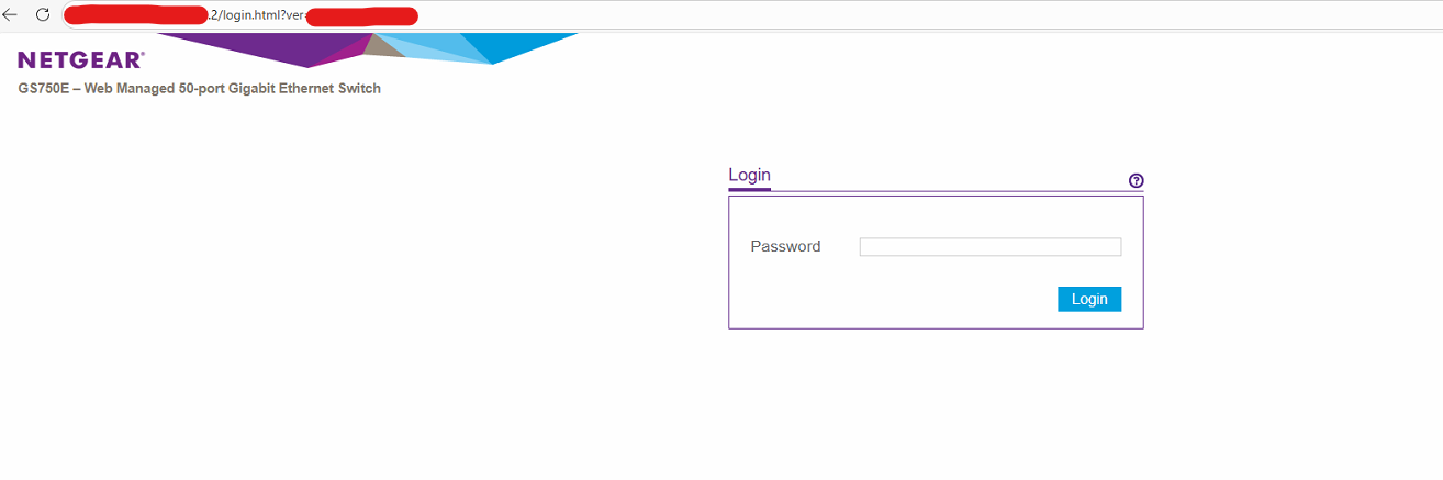

    That Netgear is a managed GS750E:
    You can find that switch inside that network on x.x.x.2

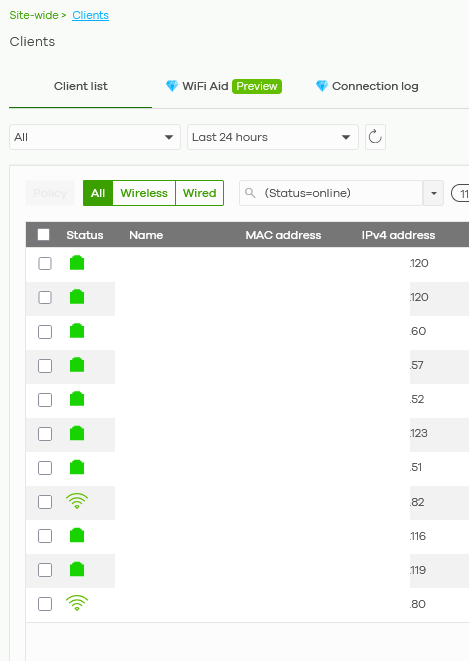

    Anyway it is NOT visible inside Clients' list:
    I don't know why.
    Original cable order was using the Netgear as main switch, collecting clients and both Zyxel Switch under its ports:
    Firewall → Netgear → Zyxel Switch1
    Firewall → Netgear → Zyxel Switch2 → Zyxel AP
    then the rest of the network….
    As soon as I can come back to that ORG I can send the Topology's screenshot with errors re-cabling temporarily the firewall and switches as they were done by electricians. It is not scheduled right now.
