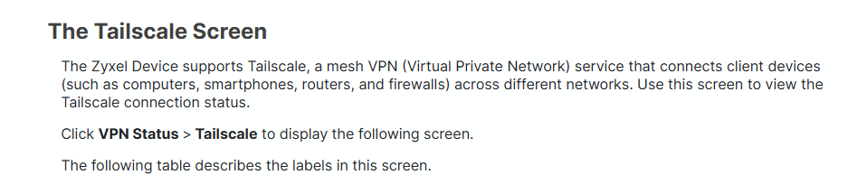

    If you check the machine/device in the VPN status > Tailscale page, then you will only see the Tailscale installed devices. The devices under Tailscale router/firewall will not listed in here.
