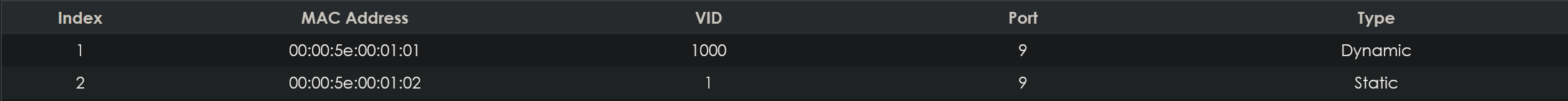

Firewall 1 is connected to Port 10 on the Switch and Firewall 2 is connected to Port 9.

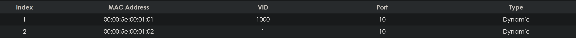

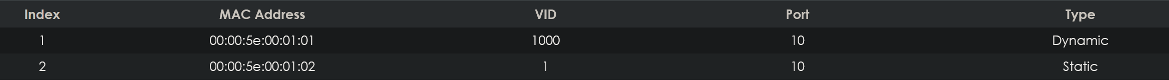

For whatever reason, only the WAN VIP works properly and has it's MAC registered as Dynamic on the Switch. The LAN MAC wrongfully gets marked as "Type" Static.
Because of this, the OPNsense High Availability is broken. When the CARP MAC switches form one Firewall to the other, the Port on which the Switch forwards the traffic won't change and is stuck on Static. It will only work again if I restart the Switch.

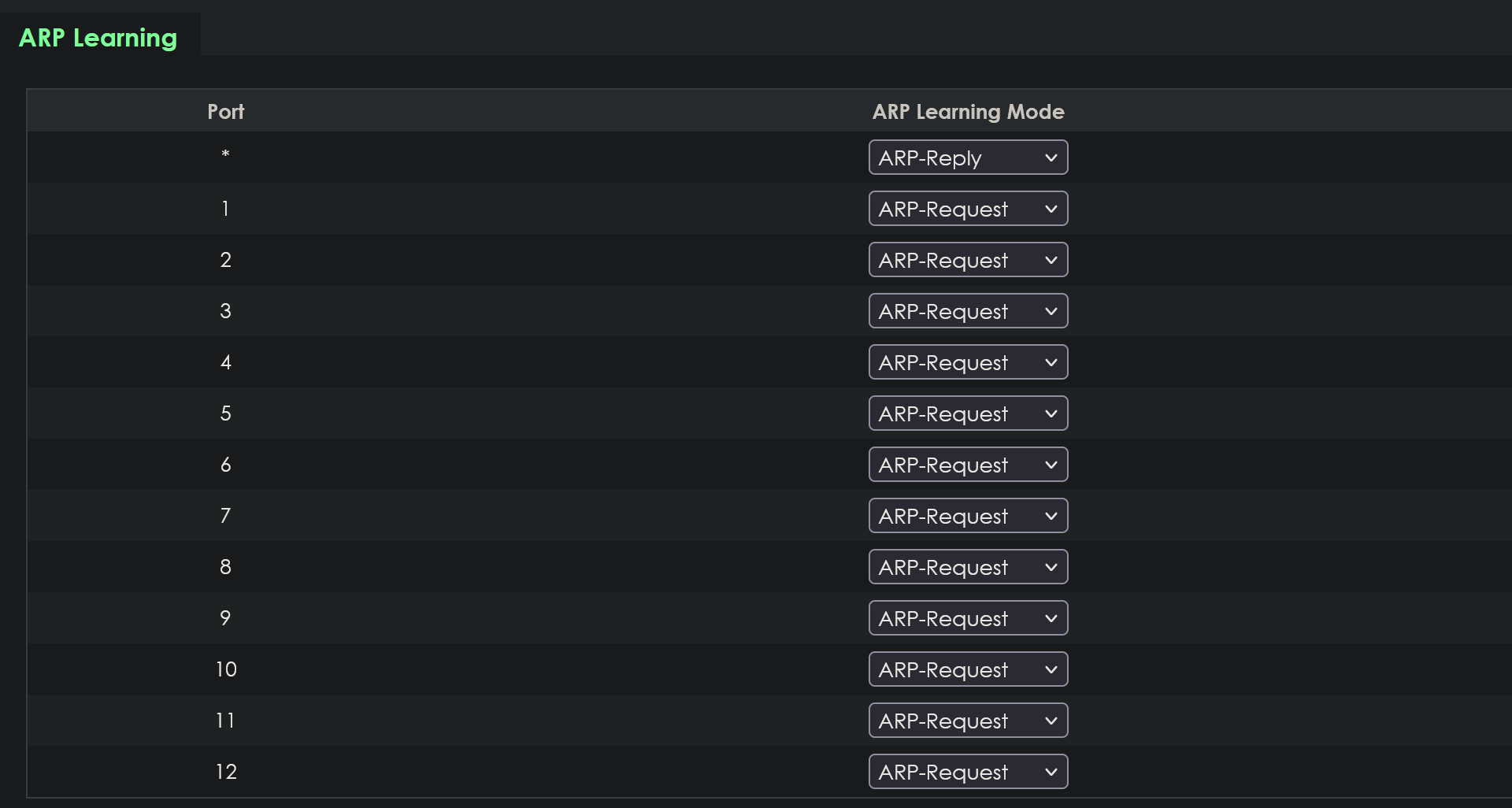

    We have experienced a similar issue on VMware vMotion and this issue is fixed by changing arp-learning mode. Could you help to change the arp-learning mode to ARP-request? Path: Menu > NETWORKING > ARP Setup > ARP Learning.
    If the issue still exist after changing, please let me know.

    Thanks for getting back to me!
    I changed the setting about a week ago but unfortunately, the issue persists. I don't know why Changing an ARP setting would affect the MAC Table anyway? The Port stayed on "Dynamic" for some time but now it's stuck on "Static" again.

    May I confirm that you have changed the ARP Learning mode to ARP request option, but the issue still exists?

    Yep, I changed the ARP Learning mode, saved the config and restarted the switch. The after the reboot, the port was set to Dynamic but changed to Static after a while.
    But just now I checked again and it changed back to Dynamic? (yesterday it was on Static)

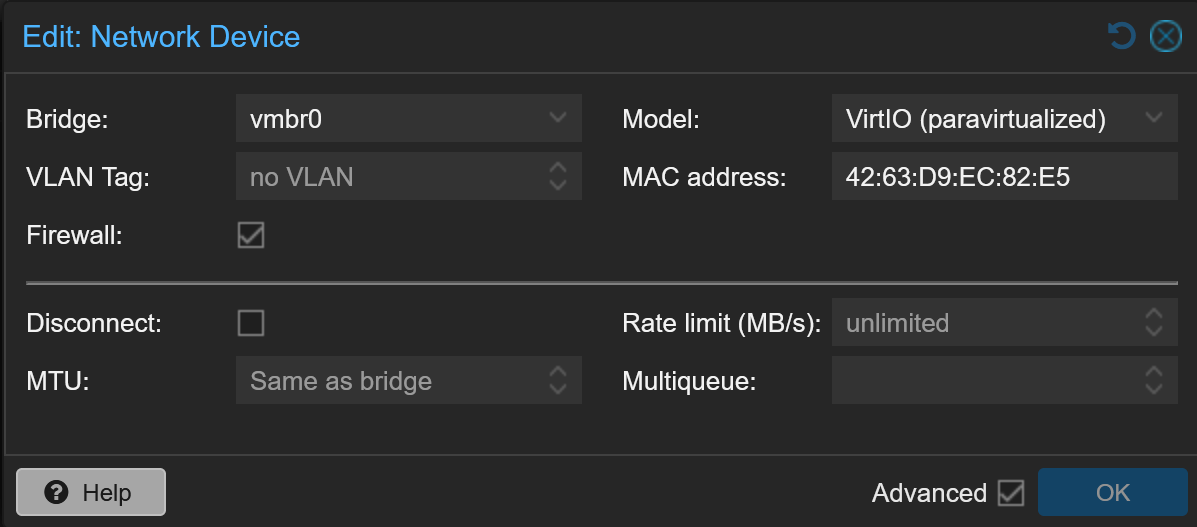

    I run OPNsense (where the VIP is configured) on proxmox, with the LAN vmbr0 Linux bridge assigned as Interface

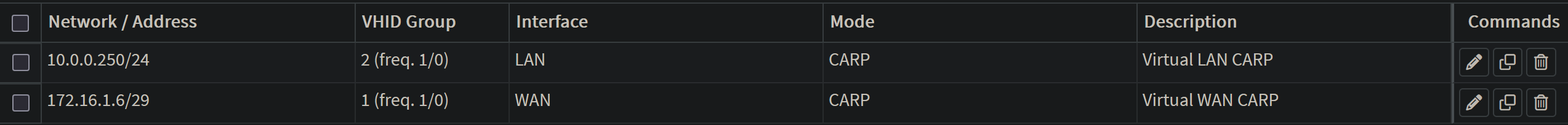

    OPNsense Virtual IPs:

    the LAN Interface is bound to the vmbr0 bridge on the proxmox VM:

    Just checked and today it's on Static again…

    And today it's back to Dynamic…
