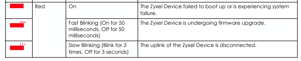

    Since the red LED can indicate three different issues, could you please confirm which one matches your situation?

    The NWA50AX led showed a solid red - which according to your table indicates an issue with booting up. I did a hard reset using the rear button and this seems to have cured the issue as there has not been a problem for a few days.
