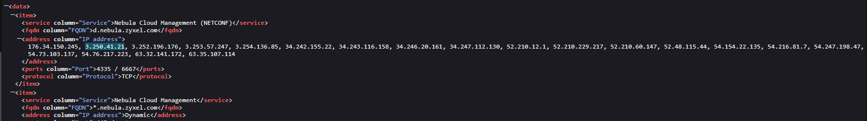

Dear Tina,
the adress d.nebula.zyxel.com resolves to 3.250.41.21, which is on the list I retrieved from nebula - help center - firewall information (also attached).
However I cant find it on your list…
