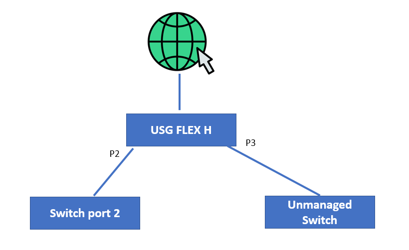

    Hi @GiuseppeR ,
    To better assist you, could you please confirm whether your topology is as shown below?
    Also, could you clarify whether your goal is to allow the devices in the warehouse (unmanaged switch) to communicate with the devices connected to Switch Port 2? Where is your new switch in this topology? …

    Hi @Zyxel_Judy
    Yes it is so. Sent a PM with priviledges.

    Hi @GiuseppeR ,
    The USG FLEX H Series currently does not support assigning a PVID (Port VLAN ID) to a physical port via Nebula in a way that would tag incoming untagged traffic and merge it with a VLAN defined on another port. As PeterUK noted, you cannot mix a tagged-port and an untagged-port within the same VLAN interface on this platform from the Nebula side.
    With your current topology, devices connected to the unmanaged switch on P3 can still reach devices on P2 through the USG FLEX H's built-in inter-interface routing — no additional hardware required.

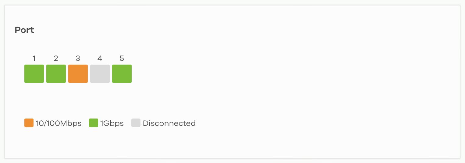

    Look at the speed of P3 😂
