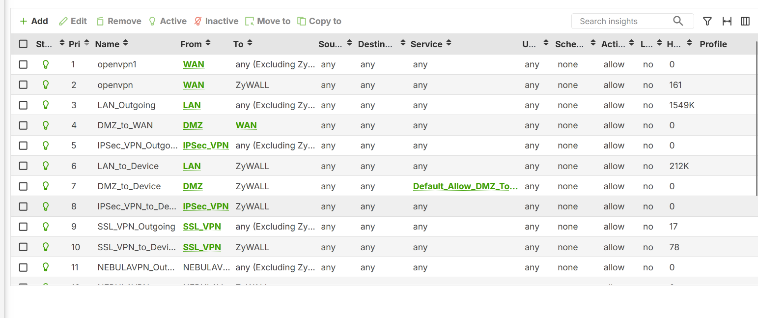

    The difference between Zywall and Excluding Zywall is Zywall goes to the FLEX H device only Excluding Zywall mean anything it can route to.
    So you don't need that openvpn1 rule just from WAN to Zywall
    The user option is only after the VPN connects not before to control where the user connects to
    You can not limit the from WAN to Zywall with user because at that point the device does not know the user.
    You can limit the openvpn by service port 1194 you can limit the source address where you user connects from by IP or Geo or you can have your users setup DDNS and use FQDN

    Okay, remote access is working. I changed the port on the OpenVPN server from 10433 to 1194 and created a rule in the Policy service. However, this rule previously had a specific user set in the user field. When I set the user field, it started allowing access. I'm including a screenshot. However, I don't think this rule is very secure for the router because it sets everything to any. How can I change it to be secure? Those are the two rules at the top. I still have a question: what's the difference between Zywall and Excluding Zywall?
