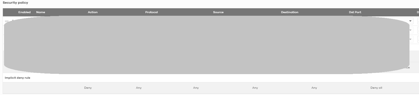

Please tell me i'm wrong.
Just noticed that if i set up a nat rule, and leave "allow remote ip" to "any", it just open up that port for any source address despite "explicit deny" rule in packet filter firewall. Also, "allow remote ip" field in the NAT rule can't be anything but a single host. You can't even put a subnet in it. I feel very uncomfortable knowing that my rdp has been wide open for days.
I really hope this is a bug and not a legit behaviour.

    Hi @SistemistaDaRidere ,
    This is expected behavior not only on the USG LITE 60AX, but also on other Nebula mode firewalls.
    When a NAT rule is configured, the device will automatically create a firewall rule to allow the specified port and source IP. This rule takes higher priority than any explicit deny rule.
    Regarding the Allow Remote IP field, we are currently evaluating support for input as a subnet or an IP range.

  • SistemistaDaRidere
    SistemistaDaRidere Posts: 21
    First Comment Friend Collector Sixth Anniversary
    image  Freshman Member
    i agree with you, that's how it should behave but It does NOT.
    You have this "implicit deny rule" at the end of the chain that should do it.
    I had to rewrite it (the deny rule) at the end of my custom rules to make it work. You can try it yoursef, set up a nat rule for everyone without opening the same service in firewall and see if it get exposed or not.
    @Zyxel_Judy
    thank you for your reply
    Just to let you know, the automatically created firewall rule is not visible in the list, also, if i rewrite a deny rule to lockout surce ip other than the expected ones, it takes priority over the nat rule.
