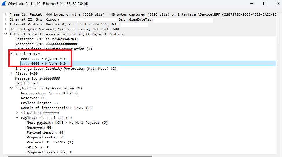

    What I they want is a first packet match to UDP port 500 to block IKEv1
    Or only have the daemon reply on match of a tunnel configured like Phase 1 Encryption, authentication and DH but this would mean no feed back as to why the connection failed if setup wrong
