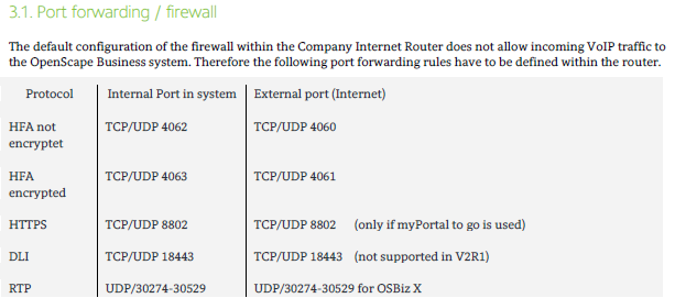

Hi, I replaced an ATP200 with a USG FLEX 100 H on a network with a public IP address and a PBX in LAN.
Some public ports were mapped via NAT to the internal PBX. With ATP200 was all ok, with FLEX H clients can start VoIP calls, but the voice didn't pass via NAT.
PBX Technincian spoke about Full Cone NAT, Restricted Cone NAT and Symmetric NAT… he wasn't able to explain exactly how it works, but checking some RFC about STUN Protocol, seems that ATP and USG FLEX H works different.
My environment seems to need Restricted Cone NAT instead of Symmetric NAT.
The following image was the instruction he gaves to me in 2020.
I found the PBX manual here
page 15.
Could you address how to configure USG FLEX H to restore VoIP softphones?
