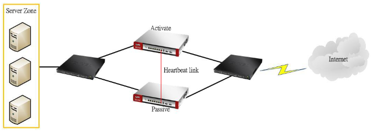

The Device HA feature acts as a failover when one of the firewalls in the network is dead or can’t access the internet. In Device HA Pro a “heartbeat link” is added for monitoring the interface status and synchronizing settings.

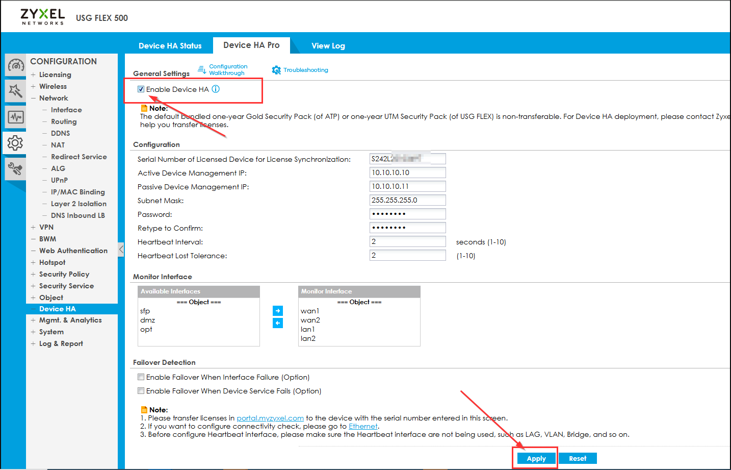

To set up the Device HA Pro feature please log into the Zyxel firewalls web interface and navigate to:
Configuration -> Device HA -> Device HA Pro
The last physical RJ45 port on the Zyxel firewall is the Device HA Management port (Heartbeat Port). Please make sure that this port is not part of a LAG, VLAN, or bridge interface.
Steps:

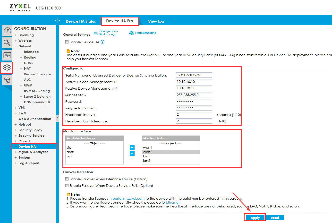

• Uncheck the “Enable Configuration Provisioning From Active Device” option.
• Verify that the serial number is the primary device S/N.
• Provide an IP address for the Active Device. (Need to be an address not in use with any of your current interfaces)
• Provide an IP address for the Passive Device. (within the same subnet as above)
• Provide a subnet mask.
• Create a sync password.
• Select the monitor interfaces from the available list and move them over to the member list.
• Configure your desired Failover Detection settings.
• Click the "Apply & switch to Device HA Pro" button.
Go to the Device HA tab again to enable the Device HA feature on the active firewall.
• Verify that the Device HA Mode is set to “Device HA Pro”.
• Check the box to “Enable Device HA”.
• Click the "Apply" button at the bottom of the screen to save the settings.

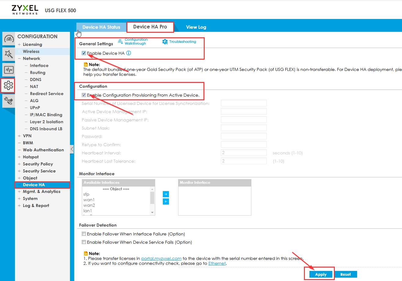

To configure the passive device please connect your computer to the second Zyxel firewall and access the web interface
• Make sure the “Enable Configuration Provisioning From Active Device” is checked.

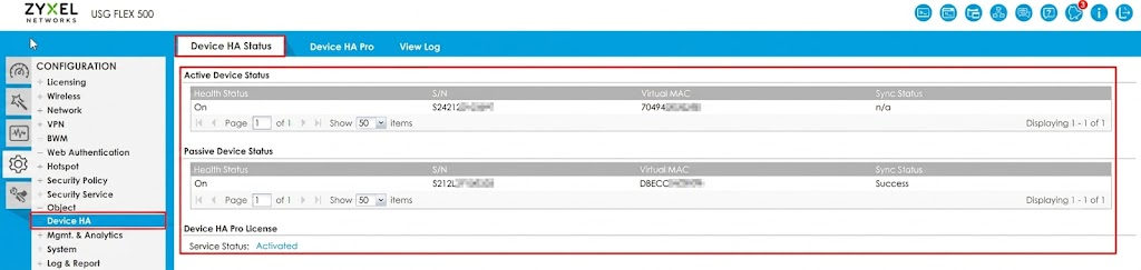

Connect an Ethernet cable to the Heartbeat Port (last physical port) on both devices and allow about 5 minutes for the devices to sync all settings. At this point, the Device HA Pro feature is configured and any changes made to the primary (active) firewall will sync to the secondary (passive) firewall.

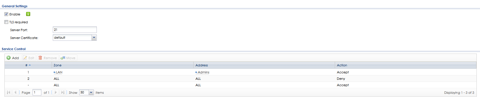

1. The sync can fail with the messages on the Passive device
The sync can fails with the messages on Passive device: Retriving Active Firmware version has filed Retriving Active Firmware version has filed Retriving Active Firmware version has filed Device HA Sync has filed when syncing Firmware Version due to bad 'Sync From' or 'Sync Port'.
A possible reason can be FTP service on an Active device has some restrictions so the Passive one can't access it.
Example of the wrong setup:
