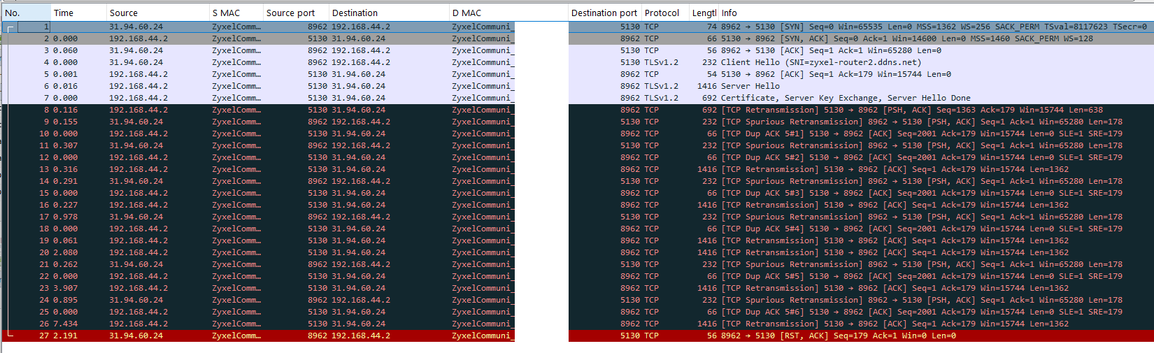

So I have a Zywall 110 I test SSL VPN LAN side it works but from the internet it don't...hmm I did a packet capture and can see the connection but it was not completing it would get to Client Hello then ACK and server hello then Certificate, Server Key Exchange, Server Hello Done then stops.
Now the Zywall 110 runs through the new uOS so I have a FLEX200 that ZLD have the SSL VPN port run through that to Zywall 110 and now it works!

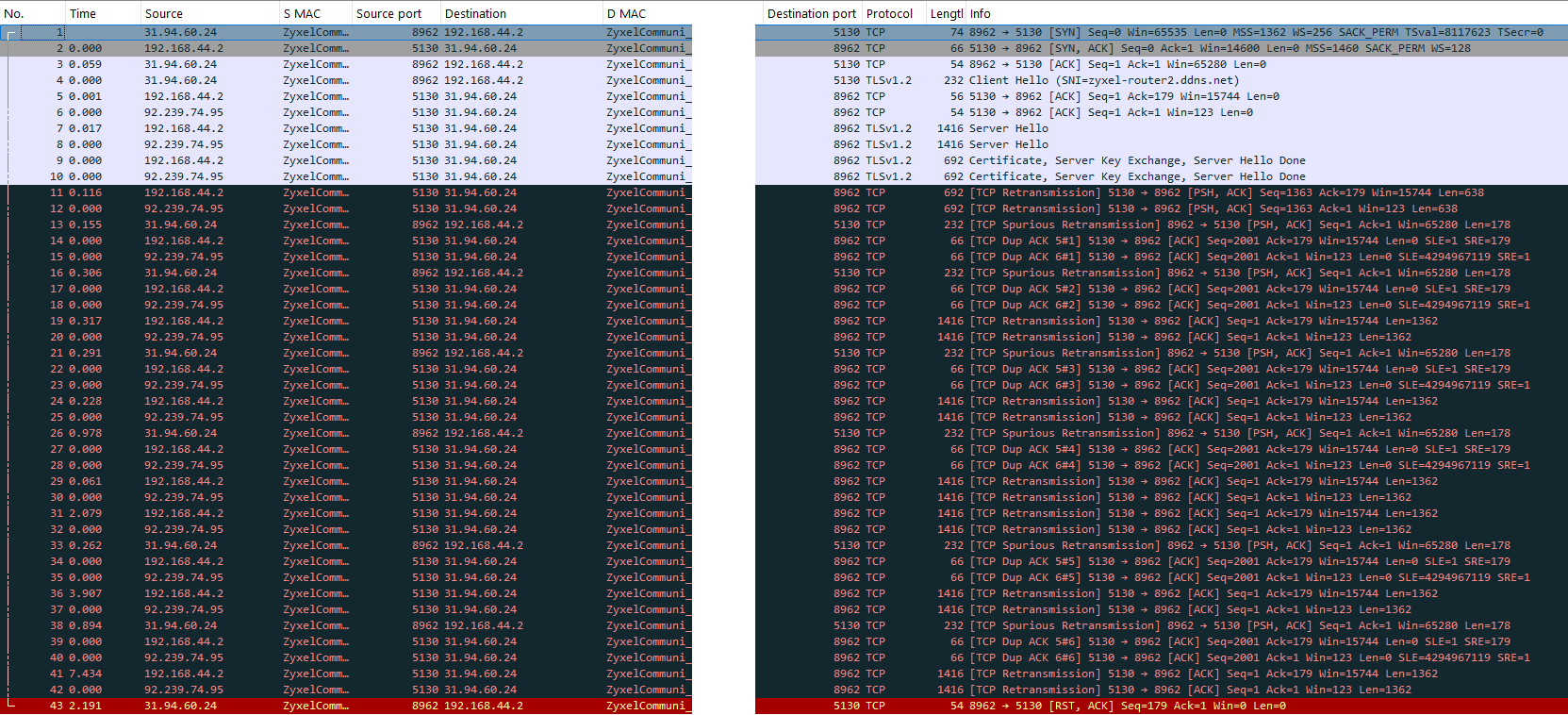

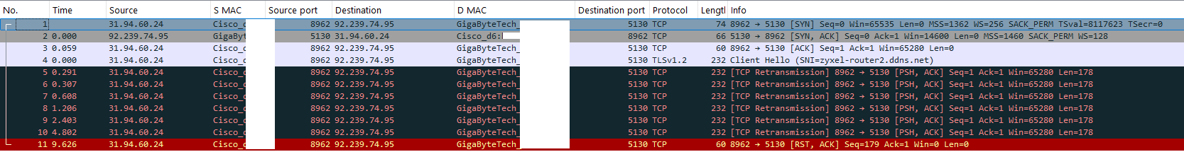

    Here is the packet capture
    FLEX 700H WAN2
    FLEX 700H VLAN443
    Zywall 110 VLAN 443

    Unless you test it yourself with the hardware you will not determine the root cause of the issue.
    I PM you the config and complete packet capture for port 5130
    The issue is clear there is two way traffic the root cause is the uOS handling and inspection of SSL traffic thats in the clear that it drops the connection thinking its invalid or not secure for some reason.
    Update
    So just to make sure the issue happens on V1.39 I found it didn't so this is fixed Tina but there was something that stopped it from working on V1.38(ABWV.0)ITS-26WK16-m11228 and did not change anything that would of stopped it from working…I mean I could go back to V1.38(ABWV.0)ITS-26WK16-m11228 to test but I'm happy its working🙂
