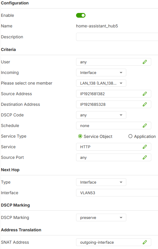

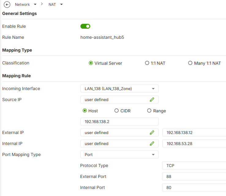

    And home-assistant.bridgemode.network and hub5.bridgemode.network that the proxy to 192.168.138.12 port 88 to FLEX 700H Secondary IP where I do
    and get a Certificate there for them subdomain by Let's Encrypt to it Nginx config
    so what I would like is a just a optional port change that can close itself when its do and is only for the challenge on what interface please it really will work and Nginx takes case of the inbound port 80 handing.
