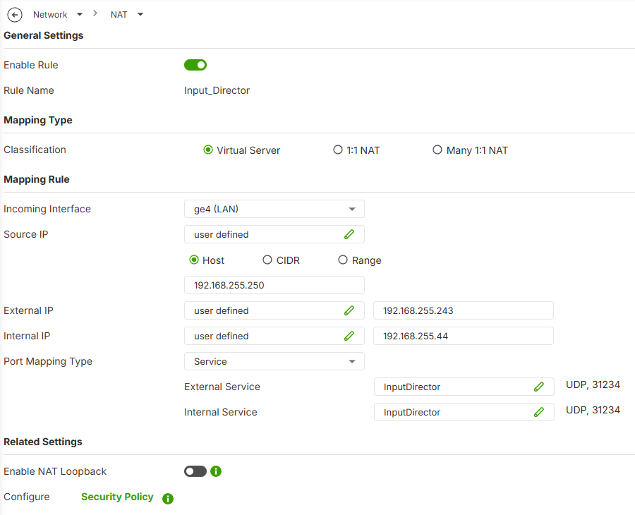

NAT rule
incoming ge4 LAN
Source IP 192.168.255.250
External IP 192.168.255.243
Port Mapping Type Input Director 31234

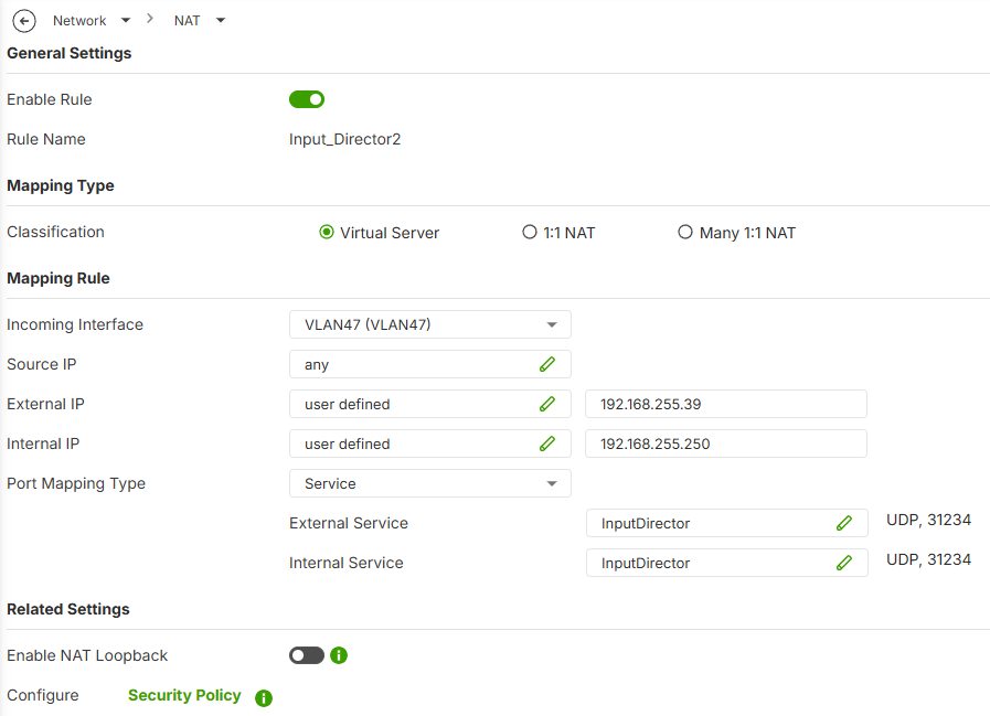

NAT rule
incoming VLAN47
Source IP any
External IP 192.168.255.39

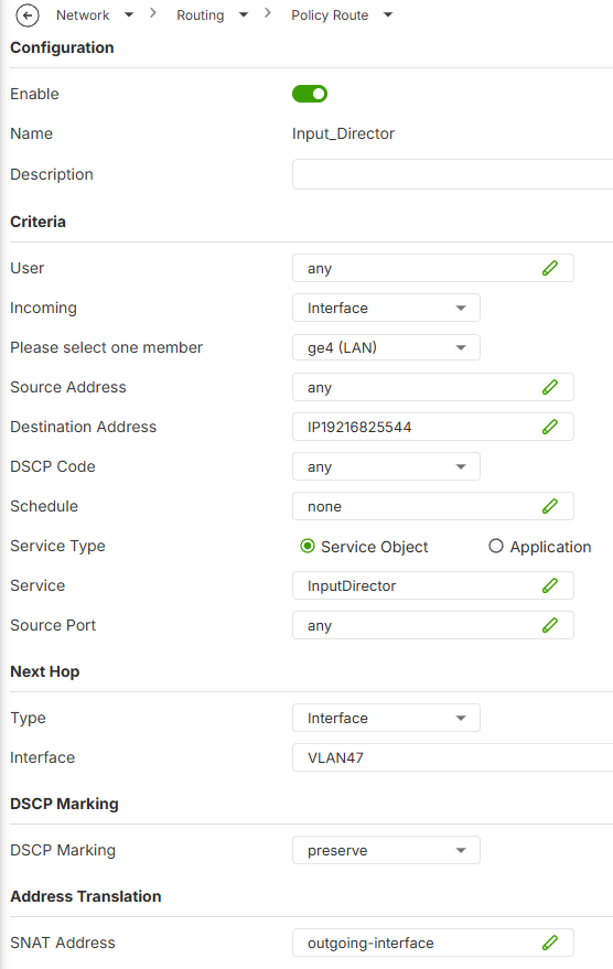

routing routing rule
incoming ge4 LAN
Destination Address 192.168.255.44
Service Input Director 31234
next hop VLAN47
SNAT Address outgoing-interface

Hi Melen
Yes forgot to add the Internal IP here are some screenshots of them rules but the real problem is Policy control where you can't set it to the to zone and this all worked fine on V1.38 but think it might be fixed in ITS-26WK32-m12287 because I have that for FLEX 700H but not that firmware for FLEX 200H
